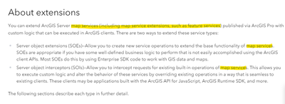

from help it seems so
MassimilianoGeppi
from another help seems to be possible create SOE for ImageService ... which is the true?
Server object extensions
SOEs are appropriate if you want to create service operations to extend the base functionality of map and image services (including map and image service extensions, such as feature services). They provide the following advantages:
from -> about-extending-services.htm

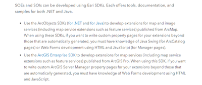

Hi Max, it depends where the sentence is written if in arcobjects or sdk context since up to 10.9.1 you can also use arcobjects where you can develop for images services
