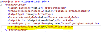

JohnMarquez
After more reading, a simpler solution turned out to be updating the .csproj with the RuntimeIdentifier tag.
