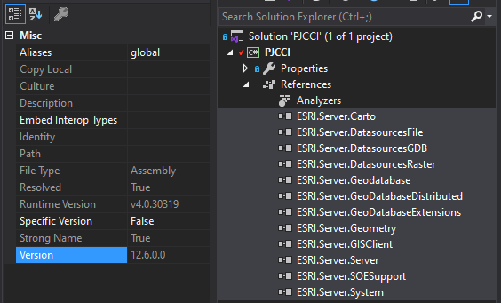

It seem the server is expecting the ESRI dll at version to be at 12.6.0.24234 but all my references in VS 2019 are using dlls at version 12.6.0.0 (located in C:\Program Files\ArcGIS\EnterpriseSDK\DotNet).
I changed the "Specific version" property for these dlls to false but it does not work either.

try edit/view csproj  because soe doesn't need this dll.
when have you installed ags have you select '.NET support extension' ? You can see in Control Panel\All Control Panel Items\Programs and Features select arcgis and unistall/change and modify and next ...
