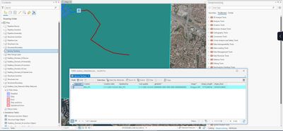

Hi,
GlobalID field appears to be zero in the Service Territory layer. What is the reason of this?
Thanks for any feedback
