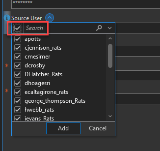

I had one suggestion/feedback though. Do you think it will be possible to include a 'Select All' option for both the 'Source User' and 'User content' parameters ?
Thanks in advance!
JakeSkinner
Esri Esteemed Contributor
@AryamanBhattacharya_BeansAI this already exists.  Click the arrow next to the Source User/User Content parameter:
Then click the top checkbox to select all:

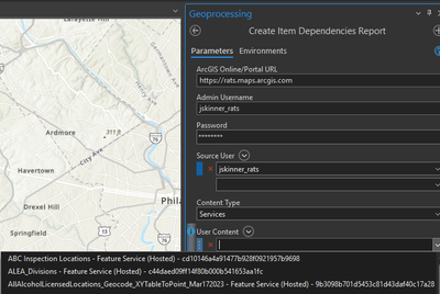

Hi! We are trying to use this tool and looking for the parameters for the toolbox if you can provide a  screen shot.
When I pull the python script into a toolbox and try to open it I receive this error message,
"Reading tool has failed. Error HRESULT E_FAIL has been returned from a call to a COM component."
Thanks for your help!
JakeSkinner
@emilymcbroomdenton take a look at a few posts up and you'll see a screen shot.  Also, the video will demonstrate the entire workflow.
Are you attempting this for Enterprise or ArcGIS Online?

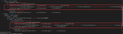

@rcGIS that was my mistake, there are changes to the Validation.  You can easily add this with the following steps:
1.  Right-click on the script > Properties > Validation
2.  Update the following lines:
elif 'Map Service' in str(item.typeKeywords) or 'Feature Service' in str(item.typeKeywords) or 'Image Service' in str(item.typeKeywords) and 'Hosted Service' not in str(item.typeKeywords):
with:
elif 'Map Service' in str(item.typeKeywords) or 'Feature Service' in str(item.typeKeywords) or 'Image Service' in str(item.typeKeywords) or 'Geoprocessing Service' in str(item.typeKeywords) and 'Hosted Service' not in str(item.typeKeywords):
May be difficult to see above, but you're just adding the following:

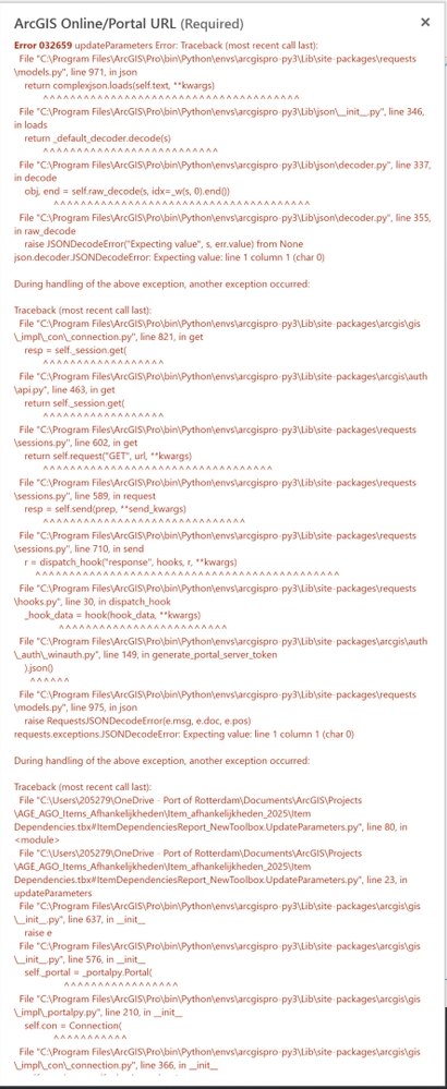

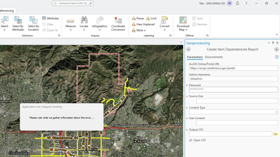

Jonathan_Marin
Hello,
I'm using arcgis pro 3.5.4 with enterprise 11.3, and I'm unable to use the tool at all. As soon as I finish typing my password for the admin user I get the "arcgis has stopped working" error message. Do you know if my combination of versions is not compatible? I have used this tool in the past without issue earlier this year.
Also, if I use our AGOL credentials the tool works, but not our enterprise portal.
Thanks in advanced!

@Jonathan_Marin the API changed at 3.5, so make sure you have the latest toolset (Item Dependency.zip).
Also, what type of user are trying to connect with?  For example, is it a Portal built-in account (i.e. portaladmin), or a SAML account (i.e. jskinner@esri.com)?
Jonathan_Marin
Hi @JakeSkinner I downloaded the latest version of the tool and I am using a built-in account. The tool basically fails the moment that I finish adding the admin credentials. If I type in a non-admin account's credentials, I get the "incorrect user or password" error as it attempts to connect, but once I type in the correct siteadmin credentials it fails right after the blue dots appear on top of the GP window that shows it validating the connection.
JakeSkinner
@Jonathan_Marin it looks like the entire ArcGIS Pro application is crashing.  This seems like an issue with your installation of Pro.  Do you have another server that is running Pro to test with?
Jonathan_Marin
Hello @JakeSkinner ,
I just did a fresh installation on a different machine and did the same steps as my workstation and get the same issues. Do you have any ideas of what the issue could be?
Thank you
JakeSkinner
@Jonathan_Marin does ArcGIS Pro crash if you try connecting to AGOL rather than ArcGIS Enterprise?
Jonathan_Marin
Hi @JakeSkinner, no issues connecting to AGOL only when connecting to portal.

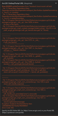

Charlie_Kaufman

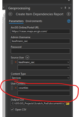

Hi @JakeSkinner, I just downloaded your Item_Dependncy.zip tool.  This looks to be exactly what I need.  I'm running ArcPro 3.5.2.  When I load all my admin credentials, I get the dropdown options for the Source Users but not for the User Content option.  I tried to type in a name to run a test but thing seem to have hung up.  Any advice would be appreciated.
Thanks
JakeSkinner
@Charlie_Kaufman does the kaufmanc_sac user own services?
Charlie_Kaufman
@JakeSkinner , that might be part of the issue.  No services just hosted feature layers.  But I switched the content type to Web Maps and still no drop down option appears.
Also, I am all of a sudden getting the infamous "error 032659" red x that many others are reporting.  But it is appearing now randomly even after I fill in all the fields.
So I am obviously in need of some assistance.  🙂
JakeSkinner
@Charlie_Kaufman the hosted feature layers are AGOL hosted feature services, which should show under the User Content.  Can you click on one of those and verify user kaufmanc_sac is the owner?
Charlie_Kaufman
@JakeSkinner oh yeah.  I'm testing this on the items that I own in my folders, so I own everything.  Is there anything else I can try on my end?
JakeSkinner
@Charlie_Kaufman is there another Administrator account you can try?
Charlie_Kaufman
@JakeSkinner, so one of our other Admins was able to see his User Content.  However, when trying to output the CSV file this error popped up. Exception: Unable to find ItemInfo for item 'a560d9bf48e74231be4ea7fb9396f025'.  I was also able to use my credentials to view our other Admin's account and saw his User Content, but got the exact same error when trying to output the CSV.
There is no item 'a560d9bf48e74231be4ea7fb9396f025'in our Organization.
I still can't see my own User Content when using my own credentials.
