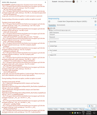

ElizabethZizzamia1
Hello @JakeSkinner ,
I am trying to use this tool in Pro3.0 and it is failing. I've used it before with success. I enter the first three parameters and it gives me an error after I enter the password. I am the Admin for my org and we use SSO. I tried using my username and _org name (bzizzami_urichmond) as well but no luck. Any guesses? I've attached a screenshot of my screen. Thanks for any help! Beth
JakeSkinner
Esri Esteemed Contributor
@ElizabethZizzamia1 SAML user account is not supported with this tool.  If trying with a built-in account, make sure you have the security question set when you first log in with this account.

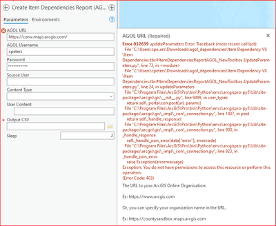

Hi,
I'm trying the "Create Item Dependencies Report (AGOL)" script from ArcGIS Pro 3.0.3 and get a 403 error after entering the URL, username, and password. I'm not the admin for the account, just have publisher role. I'm able to access my organizational AGOL account in the browser.  It's not an AGOL Portal. I don't know anything about SAML or SSO.
Thanks, Charlotte
JakeSkinner
@CharlottePeters95540 you need to be an Administrator in order to run this tool.

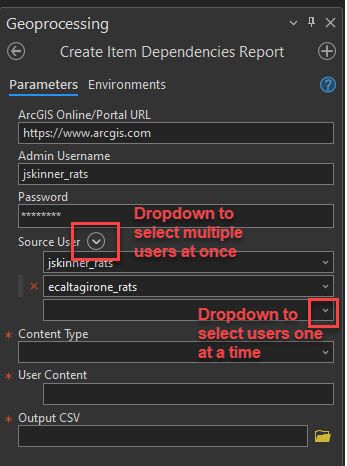

Thank you for making the great tool! We are now trying to use the tool, and we have a question. How can we just query all "Source Users" and "Content" instead of individual user (for example from enterprise portal)? It looks that with the 10/6 update, the tool can now select multiple users, but I am not sure how to query multiple users or all the users and their contents using the tool. Any example(s) would be really appreciated. Thank you!
JakeSkinner
Hi @gis_user,
You can select multiple users from the Source User parameter:
gis_user
Thank you for the example,  @JakeSkinner!
I just downloaded the tool from the link this morning, but I am not seeing the drop-down option in the tool.. (I will download the tool again to make sure.) (I am using Pro 3.1.3.) Oh, I think the drop-down option probably shows up after entering the information above (like URL, etc.).
If I attempt to query the info for all the users in the enterprise portal (production environment, for example), how should I go about it?
Thanks again!
JakeSkinner
@gis_user yes, this dropdown won't show until you fill out the parameters before.  You can select all the users, and then all the users content to create a report for all items.

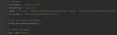

@Sibe, yes this is possible.  You will just need to specify the Variables.  Below is an example.  You can remove the portal, username, and password variables.
  • The GIS object can reference "home" to connect to Portal.
  • The items variable is a semi-colon delimited string that will require a dash between the name and id.
  • The csv_output will need to reference an ArcGIS Notebook Server workspace
