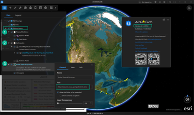

I made 3 lines in the `startupLayers` , the 1st one for local KML, the 2nd for online KML,  and the 3rd for online KMZ.  All of the 3 layers works as expected.  (Please  specific icons available on you side.)
<startupLayers name="" visible="True" icon="">
    <layer name="" type="KML" url="C:\KML\PhysicalWidthLine.kml" visible="True" icon="C:\bower.ico"/>
    <layer name="" type="KML" url="http://earthquake.usgs.gov/earthquakes/feed/v1.0/summary/1.0_week_age_link.kml" visible="True" icon="C:\xml.ico"/>
    <layer name="" type="KML" url="http://www.nhc.noaa.gov/gis/kml/nhc.kmz" visible="True" icon="C:\esri.jpeg"/>
</startupLayers>

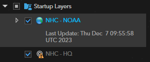

GeoffroyRicher-Lalonde
Hi @Sharon_MU,
You are right, http://www.nhc.noaa.gov/gis/kml/nhc.kmz do work as a KML Startup Layer. The problem must be with our web servers then.
I still don’t know why our organizational KMZ won’t load… The problem may occur because I test 2.1 on a virtual machine. For some network or security reason, our web servers may fail to deliver KMZ on a VM ??
Weird enough, the KMZ can successfully be loaded via Add Data window or by a drag & drop to the viewport. It just cannot be loaded as a Startup Layer from our web server…
I used the same nhc.kmz layer twice. The one loading from NOAA is correctly loading, but the one loading from our web server isn’t. So the problem must be with our web server.
