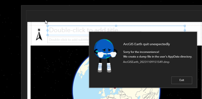

Hi,
When I export a map using ArcGIS Earth it crashes as soon as I interact with an added text box or with the default text boxes (title, etc.). Anyone have any experience with this? The features are two polygons - from KMZs.
Thanks!

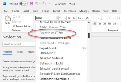

Hi @mheathca ,
Thanks for reporting this issue.
This is a known issue when the specific font is missing from Windows system.
To solve this issue In short-term (V2.0), please install the font ` Avenir Next LT Pro ` from Settings of Windows System. Here is the steps from Microsoft Support.

Hi @Sharon_MU ,
I am able to reproduce this issue (in ArcGIS Earth 2.0.0.3810) even though I have the font ` Avenir Next LT Pro ` installed
Any other fonts we have to install?
