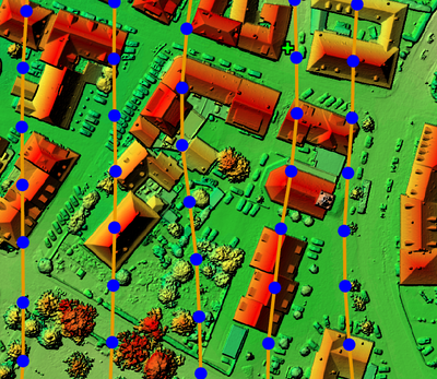

I am using Drone2Map 2024.1 to extract DSMs from drone nadir imagery. Calculating the aerotriangulation is no problem (having good results) and extracting a good DSM for most of the area functions well but high rise elements like church towers or cell towers cause problems almost every time. They do not get modeled. Image overlap is not the problem, as those problematic structures show up in up to 8 or more images.
I use dense matching Point Cloud Density: Ultra
Project Resolution: Automatic: 1x
Initial Image Scale: 1/8
Refine Adjustment: 1
Tie Point Residual Error Threshold: 5
Matching Neighborhoo: X-Large
Camera Calibration: activated for all parameters
In other software like ITwin Modeler Capture those problematic structures are being modeled in a good way.
Can you help me please? Many thanks in advance!
