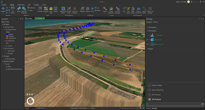

HI, we have the same problem (see image):
@GIS_Admin: can you specify better how to determine the geoid and how to change height ? Do you mean changing the metadata of images ?

AndreasHall
You should not experience problems with geoid height if you set the correct horizontal and vertical coordinate system settings for your input images and output project. That said, there seems to be cases when this does not always work.
You should first make sure that you are using correct coordinate information system settings. If you still need to make corrections manually you need to figure out the geoid height in the area where you are. In Sweden, you can download a raster defining the geoid height from the national land survey. To fix raster data, like DEM, you can use ArcGIS Pro and the raster calculator to subtract the geoid height from the DEM. As for the mesh, I am not sure how to fix it.
