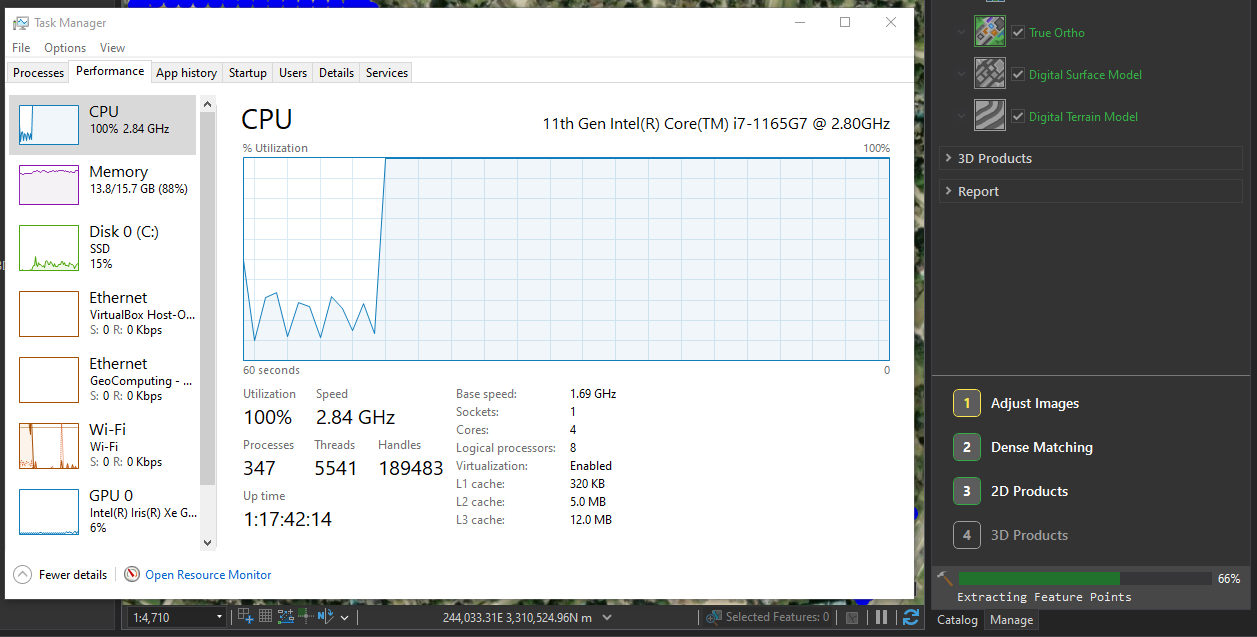

Hello, when I run Drone2Map on my local Dell laptop with 8 CPUs, the application can find and access all 8:

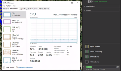

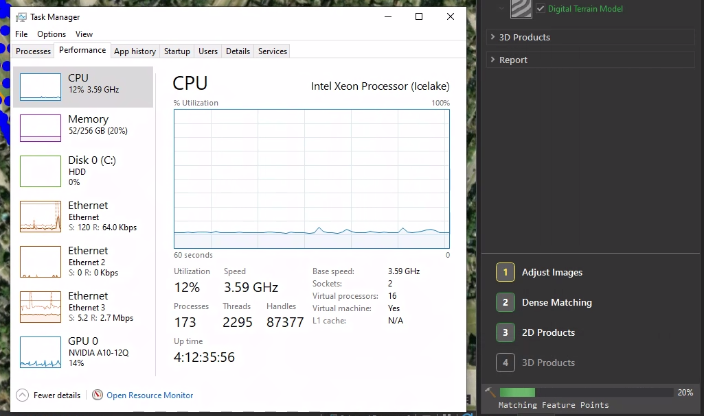

However, when I log into a private cloud virtual workstation (resources managed by a hypervisor, not a "bare metal" machine), Drone2Map only managed to engage 12% of the 16 CPUs present, or 2 of them:

Geoff, I experimented with the # of CPUs to apply to the Drone2Map task, and I got fastest results when I requested 8 out of 16 available CPUs. My processor type I also set to CPU+GPU. As a result, Drone2Map ran 3x faster on my virtual machine as compared to my laptop. That sounds like a win, but I think there's a lot of performance left on the table.
The performance should be more like 4x, based on the clock speed (2.12 faster on the virtual machine) of the 16 processors, and the fact that there are 16 of them, not 8. I noticed that Drone2Map managed to use 100% of the CPUs on the laptop, the performance meter was pegged at 100%, but on the virtual machine the CPU virtualization was very spiky... up and down, up to 100% then down to a low level, then up to 100%, etc., with the end-result being that the average CPU utilization was not that high. There perhaps some odd interaction with the software and the way the CPU is virtualized by the hypervisor?
