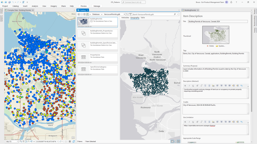

To set us up Bruce imported data from Vancouver's open data web site. The data was brought into an ArcGIS Pro project geodatabase by a spatial ETL tool (ImportBuildingPermits, in the blog download) that reads from Vancouver's open data web site.  The dots on the map are today's permit locations in the feature class BuildingPermits.
Not only was the building permit data written to a feature class it also had metadata generated by an ETL process. In the screenshot below, we are viewing the metadata for the BuildingPermits feature class in ArcGIS Pro. In the metadata we can see the item information (title, tags, summary, description, credits, use limitations).
Building permits metadataBuilding permits metadata

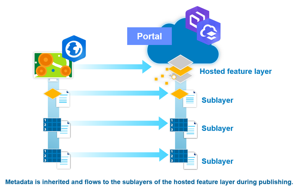

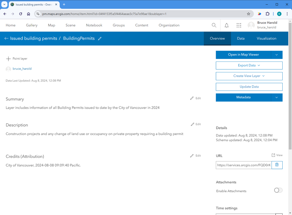

 At publication time the metadata for each layer flows to the sublayers of the hosted feature layer, like this:
..and here it is in the BuildingPermits layer:
Sublayer metadata flows throughSublayer metadata flows through
Because metadata is flowing from the data to the published sublayers of the hosted feature layer this saves Bruce the trouble of recreating it.  So that's how to get metadata into your information product at ETL time and why it's important to do so.

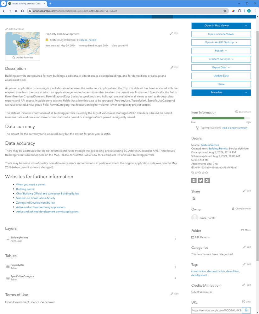

Below is the details page of the hosted feature layer in ArcGIS Online:
Item home page showing metadataItem home page showing metadata
Note, the metadata for the hosted feature layer looks amazing!! However, Bruce must confess something… he doesn’t enjoy creating metadata. Therefore, he didn't write a line of the summary, description, tags or terms of use metadata on the item details page. So where did he get metadata? How did he populate the item information on the item details page?  Using magic? (…maybe, depending on how you define magic!)
This metadata was harvested straight from the source - Vancouver's portal.

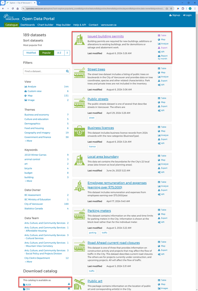

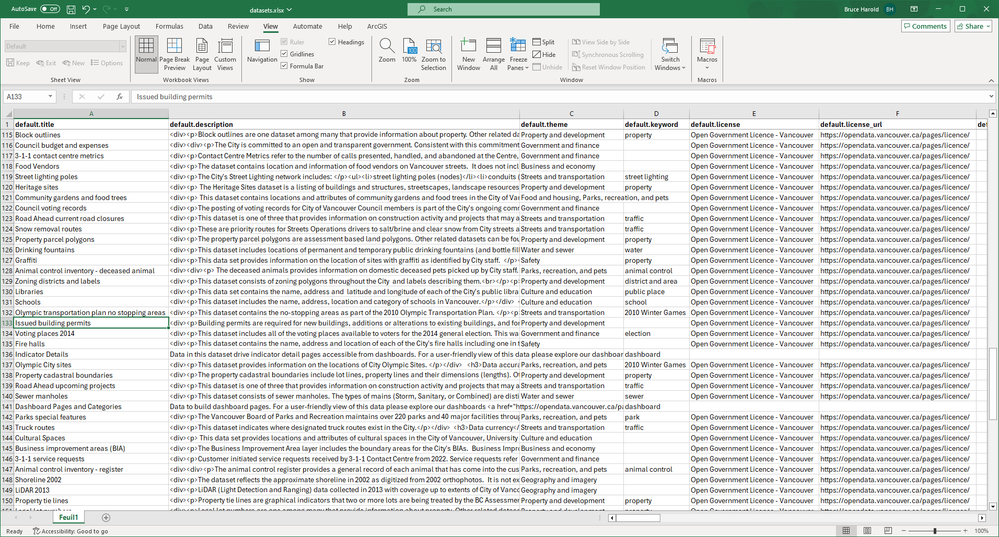

Below is the landing page, with datasets sorted on popularity (which we may be skewing 😉).  We highlight the dataset we are harvesting and if you look near the bottom we also highlight a link to an Excel spreadsheet with all dataset metadata.
Open Data Landing PageOpen Data Landing Page
Opening the spreadsheet we can see the row for the subject matter dataset - Issued building permits.
Dataset metadata spreadsheetDataset metadata spreadsheet

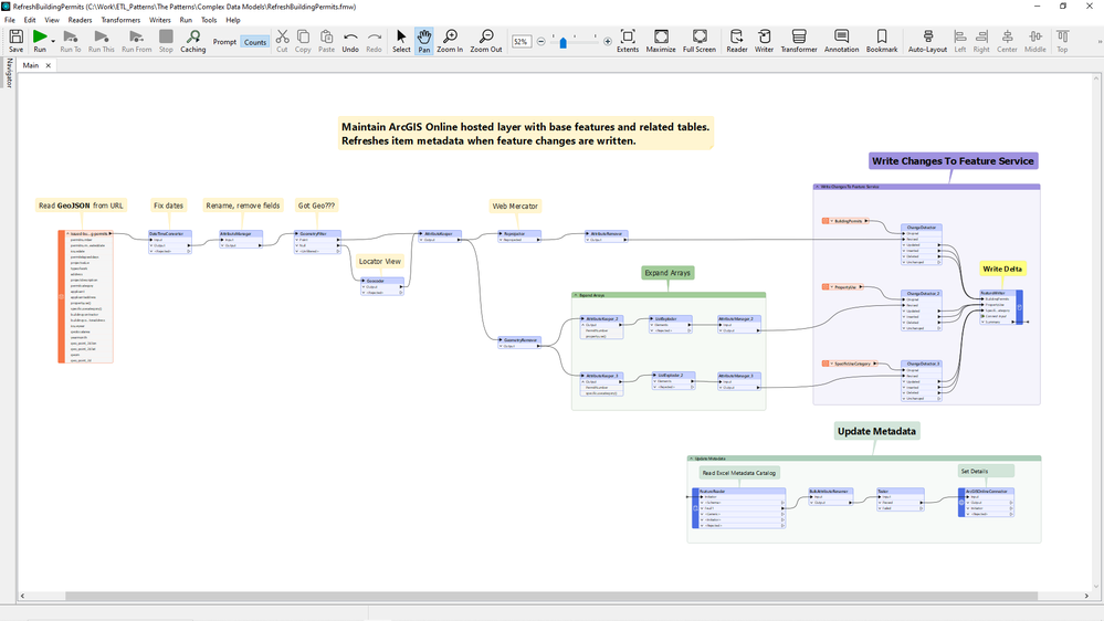

It is just a matter of getting the cell values for metadata elements from the Excel spreadsheet to the hosted feature layer - no problem - that's the sort of thing this technology was built for.  Here is where that happens, the RefreshBuildingPermits ETL tool (in the blog download) - this is it.
RefreshBuildingPermits ETL toolRefreshBuildingPermits ETL tool
Without making this a tutorial on ETL tool design, the steps we're using for our information product are to:
  • Make an initial file geodatabase incarnation of the data.
    • ...using the ETL tool ImportBuildingPermits that has the shutdown script shown above.
  • In ArcGIS Pro create the layer with symbology and pop-up behavior we want.
  • Publish the feature class and related tables as a hosted feature layer to ArcGIS Online.
  • Maintain the hosted feature layer using the RefreshBuildingPermits ETL tool.

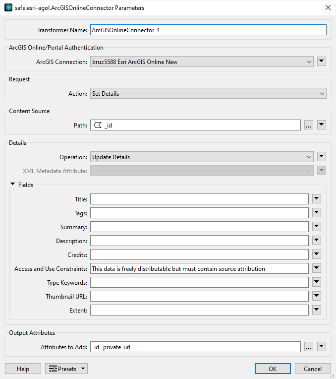

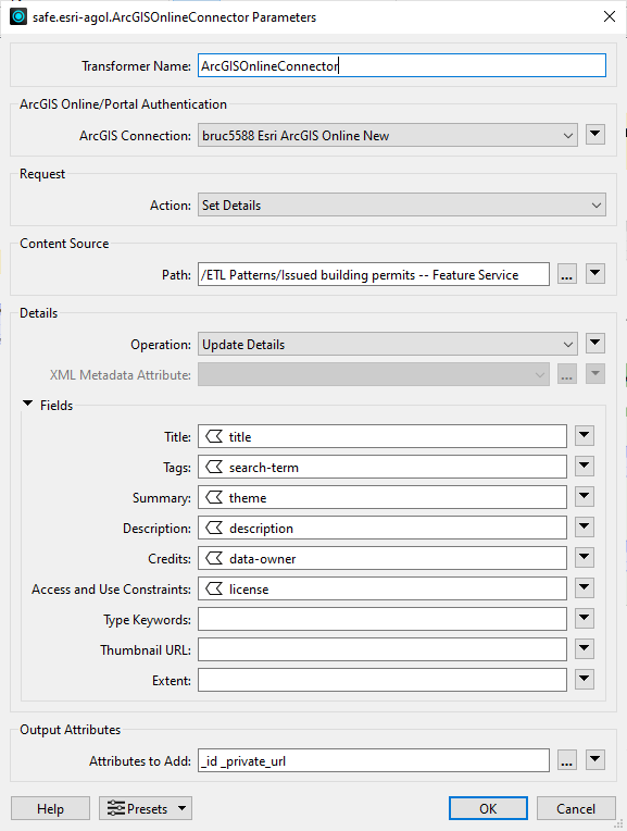

...which means we put the hosted feature layer's metadata update functions in this second ETL tool.  If you look bottom right you'll see a bookmark Update Metadata.  The FeatureWriter transformer handling actual permit data has a summary port, if any data is written a hidden connector (for aesthetic reasons) triggers a FeatureReader which accesses the Excel file on the open data site and gets the right cell contents to an ArcGISOnlineConnector (also works with ArcGIS Enterprise) with the following settings:
Set metadata details with ArcGISOnlineConnectorSet metadata details with ArcGISOnlineConnector
So it's as easy as filling in the form!  If there are no data changes there are no metadata changes, otherwise there may be.  How easy is that?  You now know how to harvest and write metadata using ETL tools!

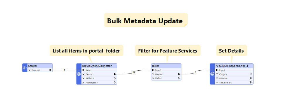

Lastly, the third leg to the stool.  Case #3, making bulk metadata changes to any number of portal items.
Let's say that we manage an ArcGIS Online or ArcGIS Enterprise organization with hundreds of items and we need to change our terms of use for all hosted feature layers in a content folder.

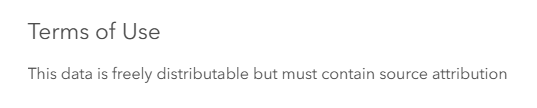

This is what we have now:
This is what we want:
This is how to effect the bulk change, it is crazy simple with another ETL tool:
It is just an ArcGISOnlineConnector used to list the candidate portal items, a Tester to filter for hosted feature layers, then another ArcGISOnlineConnector to update the target element:
If no value is supplied for an item it is left unchanged, to zero it out you would supply a value of NULL.

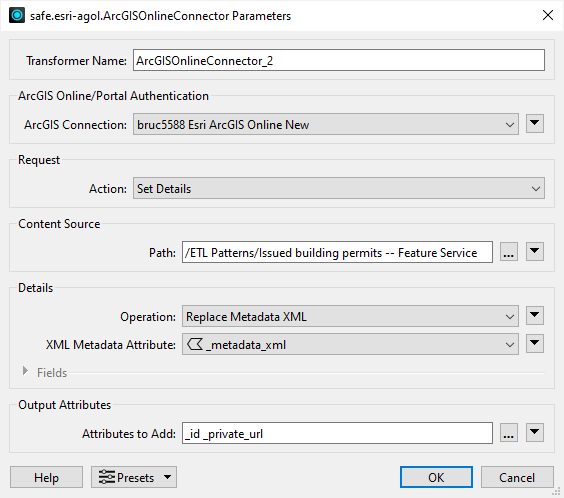

Now, we mentioned above another ETL pattern of interest is deep copying of data and metadata between ArcGIS environments, for example between ArcGIS Enterprise and ArcGIS Online.  There are core approaches for this use case in which metadata travels with the data, as you would expect, but there are also use cases where you wish to perform edits on the data and/or metadata during the ETL process.  In this situation you might work with the metadata.xml file for each dataset.  This can be accomplished with an option in the Get Details and Set Details actions in the the ArcGISOnlineConnector to get and set the value of metadata.xml.
Move metadata between portal environmentsMove metadata between portal environments
