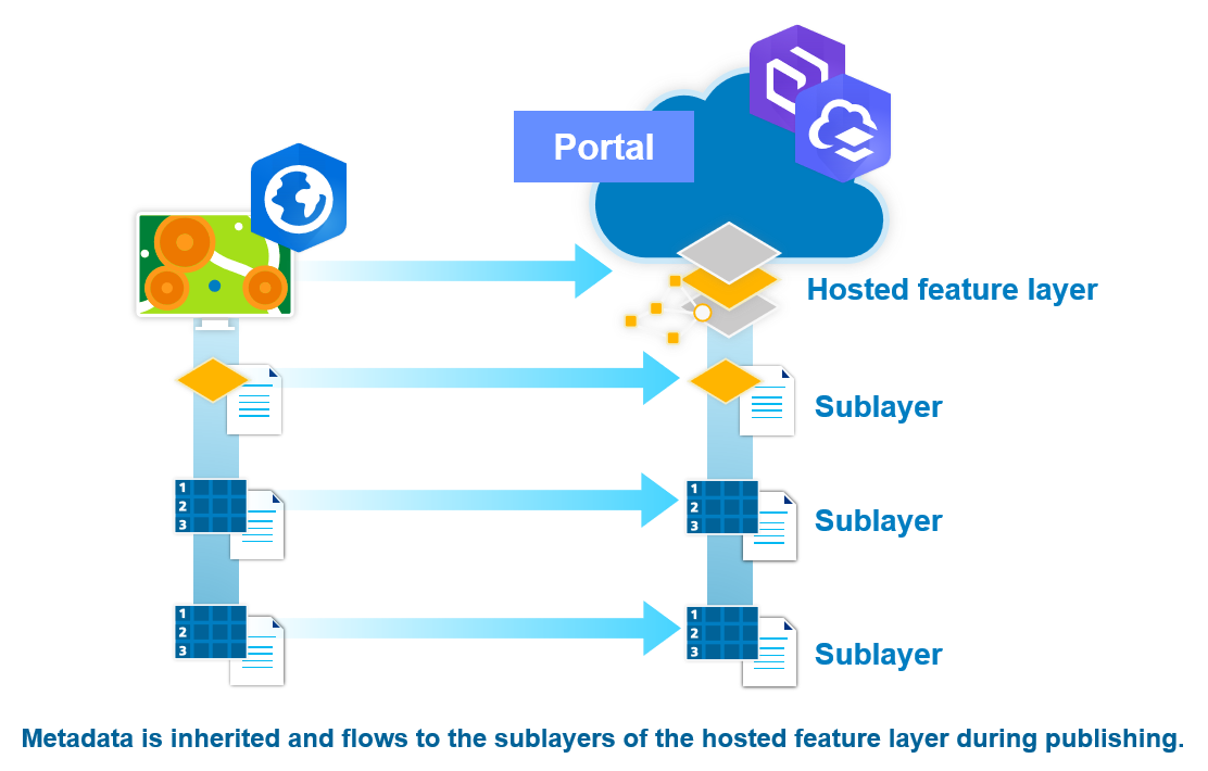

You'll have noticed in the map and metadata screen grab above that Bruce used the unique value renderer to display the data in categories (type of permitted work) and configured pop-ups. He then published the layer and related tables to ArcGIS Online - the target information product.
At publication time the metadata for each layer flows to the sublayers of the hosted feature layer, like this:
..and here it is in the BuildingPermits layer:
Sublayer metadata flows through
Because metadata is flowing from the data to the published sublayers of the hosted feature layer this saves Bruce the trouble of recreating it. So that's how to get metadata into your information product at ETL time and why it's important to do so.

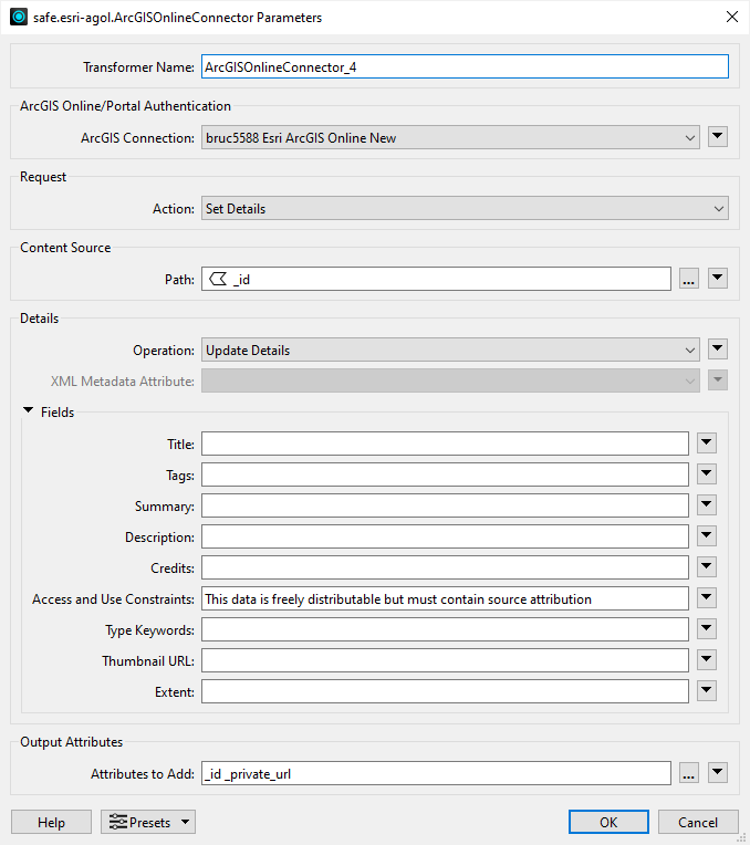

...which means we put the hosted feature layer's metadata update functions in this second ETL tool. If you look bottom right you'll see a bookmark Update Metadata. The FeatureWriter transformer handling actual permit data has a summary port, if any data is written a hidden connector (for aesthetic reasons) triggers a FeatureReader which accesses the Excel file on the open data site and gets the right cell contents to an ArcGISOnlineConnector (also works with ArcGIS Enterprise) with the following settings:
Set metadata details with ArcGISOnlineConnector
So it's as easy as filling in the form! If there are no data changes there are no metadata changes, otherwise there may be. How easy is that? You now know how to harvest and write metadata using ETL tools!

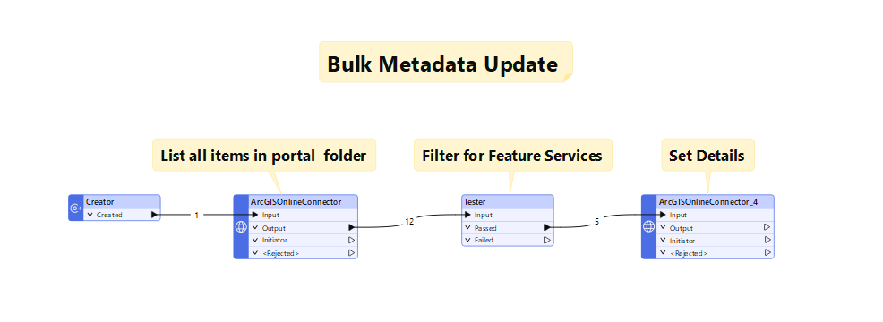

Lastly, the third leg to the stool. Case #3, making bulk metadata changes to any number of portal items.
Let's say that we manage an ArcGIS Online or ArcGIS Enterprise organization with hundreds of items and we need to change our terms of use for all hosted feature layers in a content folder.
This is what we have now:
This is what we want:
This is how to effect the bulk change, it is crazy simple with another ETL tool:
It is just an ArcGISOnlineConnector used to list the candidate portal items, a Tester to filter for hosted feature layers, then another ArcGISOnlineConnector to update the target element:
If no value is supplied for an item it is left unchanged, to zero it out you would supply a value of NULL.
