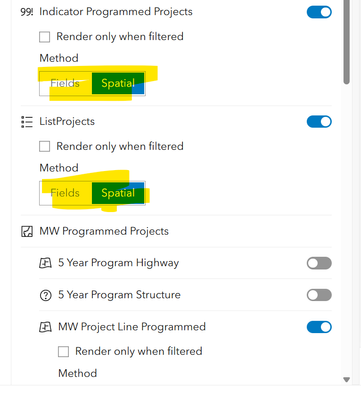

I just tried this as well, and didn't seem to work at first. I tried the first option (settings within the map frame), opting to select the filters spatially. But, what I found is that the features selection must be the same features from which the indicators, charts, etc., are derived (it appears).

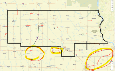

I got the "spatial Filter", however, some feature outside my selected polygon are selected.... is the spatial filter based on the "extent' of the selected polygon and the "within" the polygon?

DominicRobergeIADOT
I solved my problem looking at this post:
You have to select FEATURES and not Grouped values
