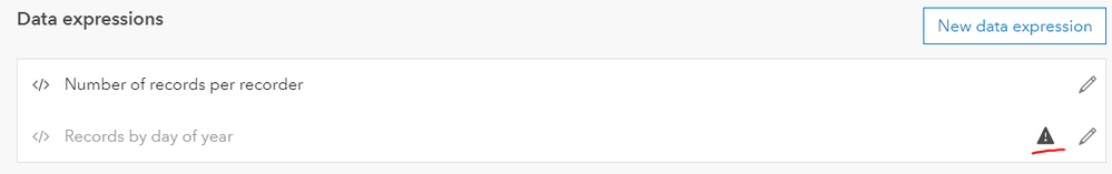

Thank you for your help on this. Testing the code you provided shows this works with my data too. However in Dashboards, when I click Done, it shows thee is an issue with the Data expression and doesn't let me use it for the Serial Chart. Hovering on the warning symbol shows the warning: "Unable to execute Arcade script"
I'm assuming I need to return a FeatureSet rather than a value. Do I need to create a data schema (as suggested in this thread: https://community.esri.com/t5/arcgis-dashboards-questions/arcgis-dashboard-data-expression-quot-unab...)? In my case, I will need to return the number of records per unique day of the year.
