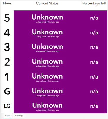

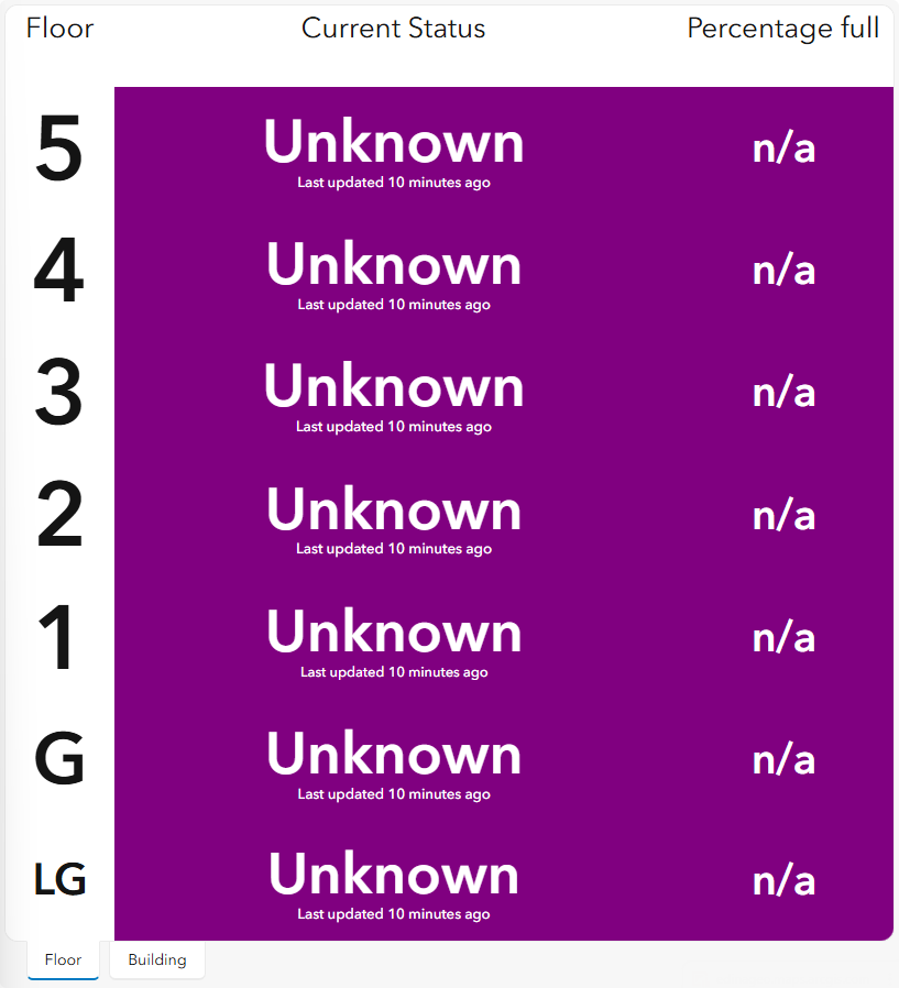

The occupancy data is held in a hosted table in ArcGIS Online and is updated every minute by a process that uses the ArcGIS API.  The Dashboard is configured to display in a different colour if the data is more than 5 minutes old, a situation that should never arise.  However, despite modifying the various refresh settings the Dashboard does not usually display up to date data and usually appears like this:
Note that in the screen grab above it shows that the most recent data is 10 minutes old, which isn't the case as it is updated every minute.  I have verified the data is up to date by using the Query interface to the REST URL for the hosted table and I can retrieve data that is around 1 minute old.
