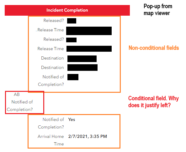

Though formatting worked fine in the pop-up, in the dashboard for this data, none of the formatting was respected, and everything was left aligned (see screenshot 1).
Note that in addition to not working in the dashboard, there is an additional field that doesn't respect formatting in either the map viewer pop-up or the dashboard viewer.
That item is a conditional field that lives in a table where all other fields are not conditional. To apply the conditional expression, I added the display attribute in the <tr> tag for the field as opposed to the table tag:
<tr style="display:{expression/expr0};" valign="top">
    <td style="padding:2px 10px 2px 2px;text-align:right;width:50%;">
		AB Notified
    </td>
    <td style="padding:2px;text-align:left;width:50%;">
		<strong>{notify_ab}</strong>
    </td>
</tr>
As seen in the second (map viewer pop-up) and third (dashboard) screenshots, the text-align calls are not respected and everything is pushed left.

Is it not possible for HTML tags to retain formatting when conditional expressions are added to it?
The CSS display attribute has many possible values. Take a look: CSS display property (w3schools.com)
It's important to choose the right one. You are using block. This basically displays the element as though it were a paragaph (<p> tag), which probably messes with the formatting.
Try to use
  • "display: table;" for the table conditional
  • "display: table-row" for the tr conditional
Is there a limitation for dashboards to not respect HTML formatting for conditional expressions?
There are some limitations for what you can do with HTML in ArcGIS products. But this doesn't seem like one of them.
why does formatting seem to be respected (at least in map viewer) when the conditional expression is added to the overall table (<table> tag), but not when it's added to individual rows of a table (<td> tag)?
Rendering HTML and CSS is a tricky thing. Every browser does it a little differently, and as you discovered, even apllications from the same vendor can handle it differently. For us non-web-developers, these corner cases often come down to trial and error.
