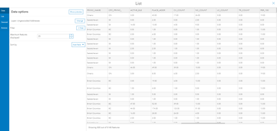

I'm relatively new to using Arcade and I have been scouring the Internet, trying to figure out how to use Arcade Expressions for the List widget on Dashboard. I am simply trying to display my data like a table, using the List widget. I know that a Table widget is currently in the works but, in the meantime, I would like to use Arcade within the List widget to display my data.
So far, I haven't had any luck getting my data to display in the List widget when using Arcade Expressions. The "Feature" functions don't work for me at all and I only have "$datapoint" available as my Global functions. I don't understand the difference between the two.

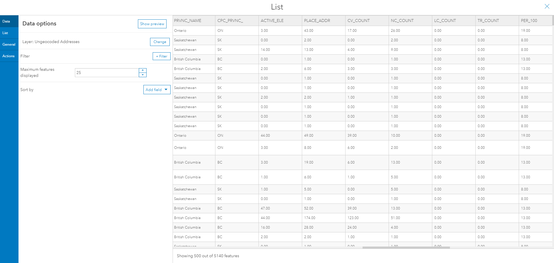

Here is my data:

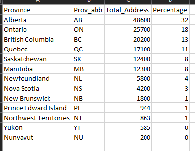

I'm hoping to display the data in a table and for it to look something like this:

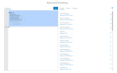

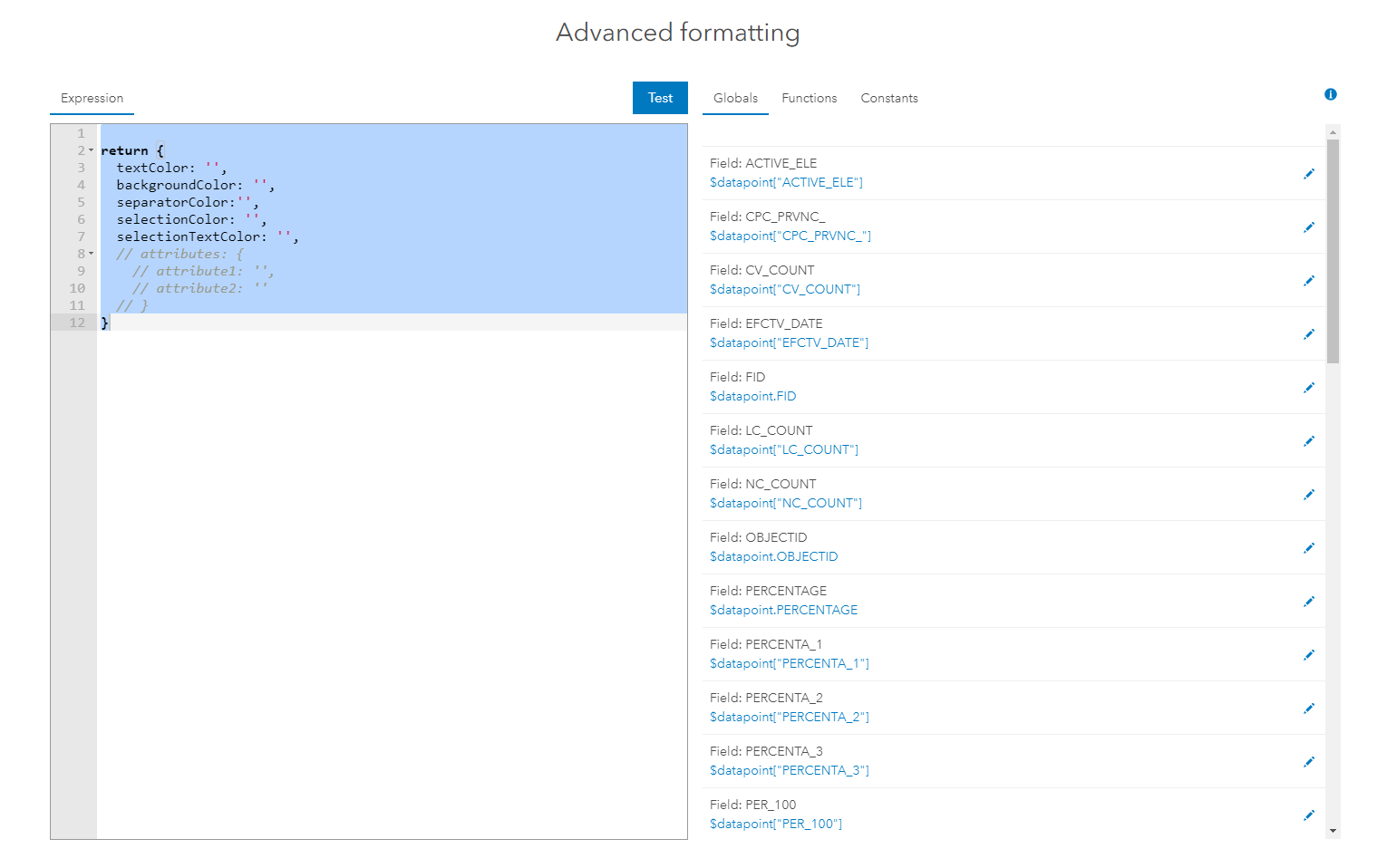

And here's how it gets displayed in under the Advanced Formatting, in the List widget:

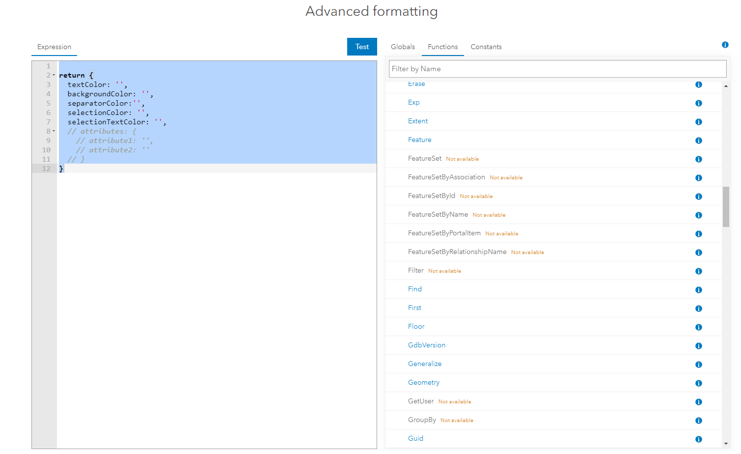

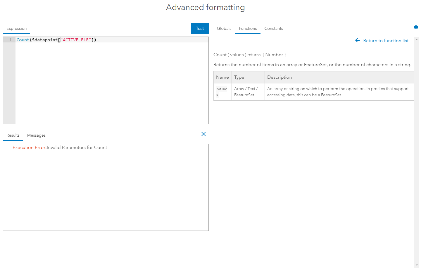

As you can see, FeatureSet, FeatureSetByAssociation, etc. are unavailable to me. I also tried using any function with my data just to see what it would look like:
And it doesn't work as I have to use FeatureSet.

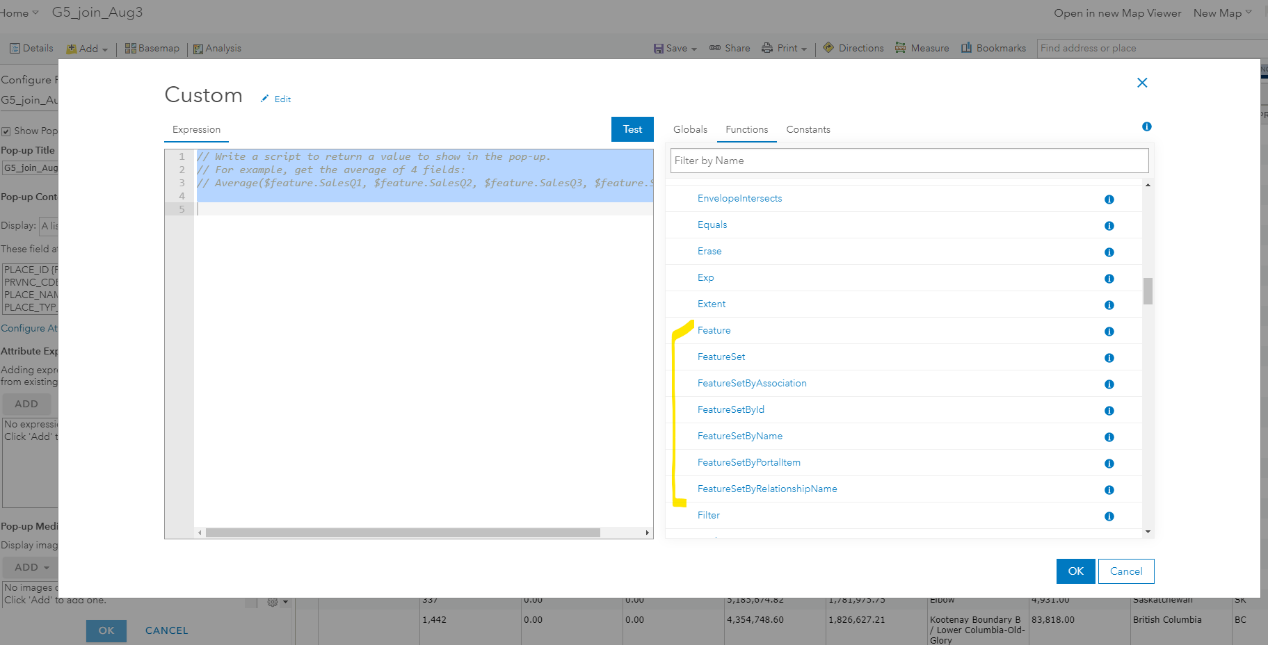

Is there anything wrong with my data? I don't know how to get "FeatureSet" to display on the List widget. I looked to see if FeatureSet was available to me in the pop-ups and it is:

Yes, that's correct. To write the expression, you'd need to use FeatureSetFromPortalItem to bring in your layers.
Look at the sample expressions here for some guidance. They can be very flexible in what they do and the kind of data they return, but there should be one or two examples in that repo to get you started. You can also look around the Community to find other posts about Data Expressions that include code snippets.

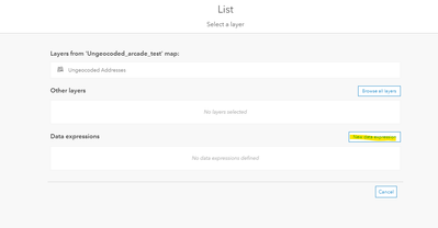

Hi Josh,
Would I write the Data Expression here?:
And write them here:

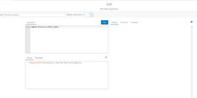

Since I didn't pick any layers, there is nothing under "Globals" so, how would I write the expressions?
Thank you!
jcarlson
MVP Esteemed Contributor

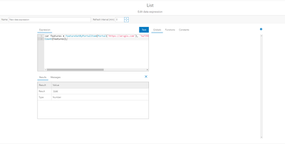

JennyKuan
Awesome, it worked! I'm able to run simple things with it now:
Thank you so much for your help!
