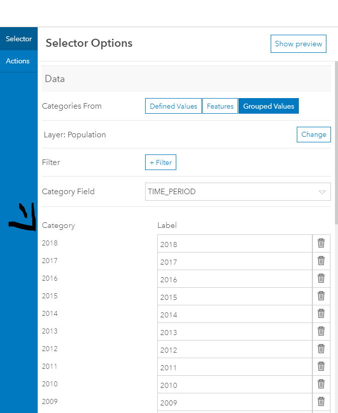

Hi, there are two options that I can think of:
1. create a field that stores only year and filter like this:
Category Selector

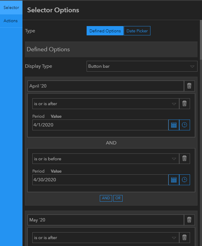

Or filter manually the year with the calendar, like this:
Date Selector
(my sample filters by month, but same concept)
