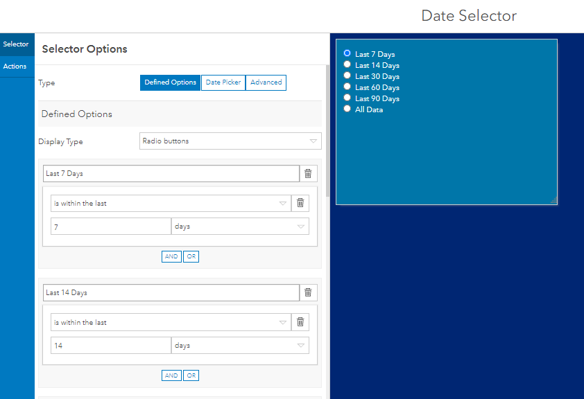

I have a COVID dashboard that includes a list of daily case numbers.  I'd like to have a selector that has options to display data for either the last 7 days OR various other time frames.  I'm currently using the Date Selector, but the problem is that depending on the current time of day and on the date/time associated with the data records, when I use the "within last 7 days" I get either 6 OR 7 values.
I understand that this is an expected behavior, based on a very literal, precise interpretation of "Last 7 Days" that includes TIME (so the filter would be more properly named "Last 168 hours").  What I need is to show the last 7 daily values.  My human users expect to see 7 values when they ask for the last 7 day's values.
Is there any way to do this with the dashboard Selectors?

JayJohnsonWashoeCounty
Hey Derek.
Let me expand on this a bit.  Our COVID data gets updated once per day, at some random time each afternoon.  If I use the "Last 7 Days" selector, I get some variable number of results in my list, depending on the TIME OF DAY that each daily update occurred.
Example 1:  The current time is 3:30 PM.  If data has already been uploaded today AND if 7 days ago the data was uploaded at 6:00 pm, the "Last 7 Days" Selector will return 8 values.
Example 2:  The current time is 3:30 PM.  If data HAS NOT been uploaded for today AND if 7 days ago the data was uploaded at noon, the "Last 7 Days" Selector will return 6 values.
Both of these results are technically correct, but it feels unpredictable to the users in the context of "what does the pattern of new COVID cases over the last 7 days look like?".  I think the disconnect here is that we humans often think of days more like integers (i.e. the most recent 7 calendar days for which we have data), while the Date Selector is more analogous to decimals (what data exists within the last 168 consecutive hours).
What I'm asking is whether there is a style of selector that can consistently return a list of the last 7 daily values, or 30 daily values, etc.
Thanks,
Jay
Thanks for the suggestion Derek.
The simplest way to state what I want is -- to give the user the ability to display the last N values (generally the last 7 values, but also the last 30, 60, etc.).  Depending on whether today has a value yet, the "last 7 values" will include a values from either the past 6 or 7 days.  I've concluded that the current Selector categories just won't work for what I want, so I've submitted an Idea:  Dashboard New Selector Category (display most recent N values)
Thanks for talking this through.
