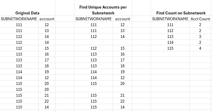

I'm trying to create a special arcade function in a Dashboard List (Enterprise 10.9.1) that finds the unique between two fields and then counts the number of one field.  The below screenshot is a example of data.  I have entries with multiple subnetworks.  Within the subnetworks there is accounts, the accounts can be duplicated across the same subnetwork and across other subnetworks.  I want to find only where the subnetwork + account are unique (this way the accounts that run across multiple subnetworks can be counted in each).  Then once I find the unique I want a count of each account  within each Subnetwork.  Below is utilizing the GroupBy function that I get the first GroupBy to work, but the second GroupBy returns a blank table.  I also tried the Distinct function and I get similar results and the Distinct tends to crash the entire Dashboard.

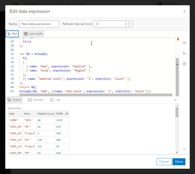

Yes, if I run your logic on my dataset, it does return the expected nested group
This is the result of the first GroupBy
and this is the result of the second GroupBy

KenBuja
MVP Esteemed Contributor
It's an implicit return, so line 46 was the last line of code

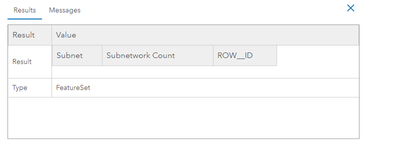

@jcarlson when watching the network log of the browser tools when I run the first group by, I get the results in a matter of a second and the log shows
But when I run the it with the second Group By the blank result window pops up immediately as I have screenshot above, but the log just repeats pulls the same query over and over and over again.  I let it sit for 5 minutes and it just continues.
