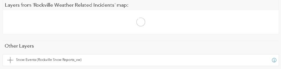

I'm trying to select layers from a map for the list widget in a new dashboard. The area where I would expect to see the layers is just a spinning icon.
spinning

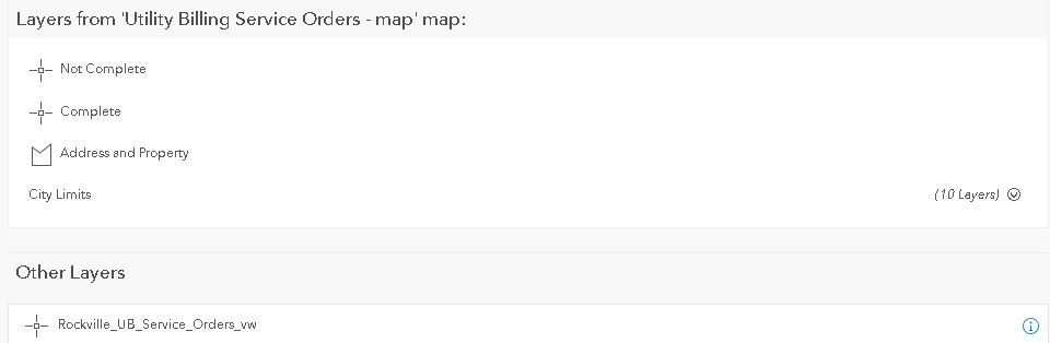

In a different dashboard I can see all of the layers from the map so I know I should be seeing something.
layers shown

On the first issue I am using a map with a hosted feature layer view. I can add the map 'Rockville weather related incidents'. When I add the list I'm still getting the spinning icon, however, if I click select layer and choose the layer view through this process then it shows me the layer and associated table. I am able to make it work. The process just seems different than what I've done in the past. I'm still learning so maybe it is not as different as I think it is.

I'm experiencing the same behavior with a completely different dataset. I just published a feature layer from SDE. I created a map and added it to a new dashboard. I'm adding a list and I'm at the screen where I am supposed to see the layers from my map. All I see is a spinning icon. If I click on Select Layer and choose the map I just created then I can see the layers.
