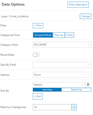

Many dashboard element config options include a setting for Maximum Categories. Used in combination with one or more Sort By fields, a Top (N) result can be simulated. Unfortunately (as one post in this thread has requested), this setting is not exposed for pie charts who get their categories from Grouped Values.
Serial chart:
