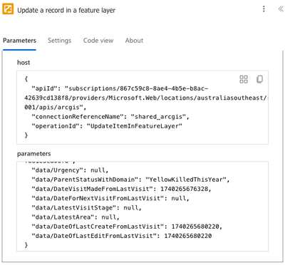

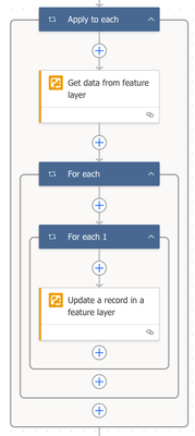

It's the ArcGIS connector with the "Update a record in a feature layer" step.
We're getting the null values back from a "Get data from feature layer" step (running against a child table) and passing them to the "Update a record in a feature layer" step:
Here's the Edit view of the Update step:
Here's a run with the null values:
and some feature layer fields after being updated, showing 1 Jan 1970 and 0.00:

@NigelCharmanPre-Prod Thanks for sharing this. I was able to reproduce this when tried using the function null, If I don't pass anything then it creates a null. I am having our developer look at this. If you must make your flow run, try and see if you can pass nothing when the input is null.

@AkshayHarshe I don't think it's possible to conditionally select which fields are updated in this step. The only way I can see would be to call different steps dependent on whether the fields are null. But since we have 5 fields that could be null, this would require 5! steps, which is unmanageable. I think we'll need to create a Notebook to modify the fields that have been written incorrectly.
Thanks, I can confirm that the fix solves my problem 😀
