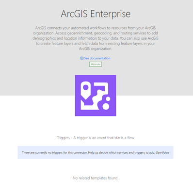

Recently upgraded to Enterprise 11.1 and I'm trying to test out the Power Automate Connector for ArcGIS Enterprise. Unfortunately, there are no triggers available when I view the connector. Anyone else having this issue? I know it was recently released, so there may still be some things they're ironing out.

Good Day @Clayton-Cooley  - currently there are no triggers for ArcGIS Enterprise, but here is a blog post on you can enable webhooks and begin using the Connector. We are looking to deploy triggers in the Enterprise connector in conjunction with the ArcGIS Enterprise 11.2 release.
