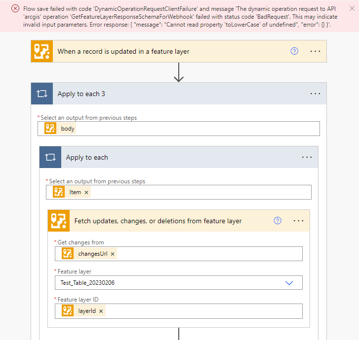

I'm running in to trouble with Table layer types. When using the Fetch updates, changes, or deletions from feature layer action, whenever I select a feature layer that is a table, I get the following error when trying to save.
Flow save failed with code 'DynamicOperationRequestClientFailure' and message 'The dynamic operation request to API 'arcgis' operation 'GetFeatureLayerResponseSchemaForWebhook' failed with status code 'BadRequest'. This may indicate invalid input parameters. Error response: { "message": "Cannot read property 'toLowerCase' of undefined", "error": {} }'.
Is there a special process for table layers? Or are they simply not supported?
Update Edit: I also get the same error when using a Table in the Get data from feature layer action, but only when the Output format is set to JSON. I am only able to get Table data as CSV. This makes me think that there is an issue treating Tables as JSON.

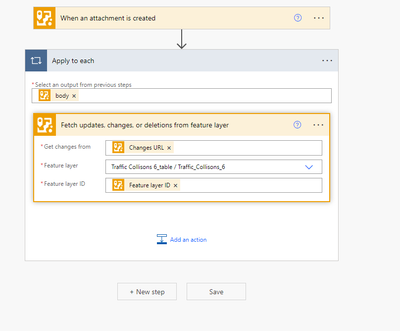

@Kuyler_JonesCivil - Hello there! My name is Anthony and I am a product engineer on the ArcGIS for Power Automate connector. I was looking over this issue and I would like to help out if I can!
We have just pushed a number of fixes earlier this afternoon that should resolve this issue. Please let me know what happens when you attempt to recreate or run this flow again. Below is an example using a table in an action and having it succeed.
You should be able to save the flow without any issues now.
Kuyler_JonesCivil
@AnthonyLatini thank you for the swift response. It seems that the issue has been fixed.
