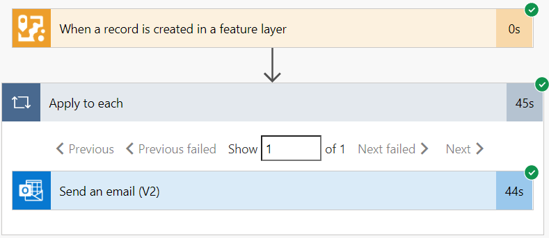

 @SeanKMcGinnis  I’ve performed some simplistic testing and can see the following behavior:
If I set the flow up as shown below it works as intended and only sends an email when new records are created in the feature service.
    • When a new record is created
    • Apply to each
      • Send email
The issue with this is that we have no access to the attributes of the new feature/dynamic content.

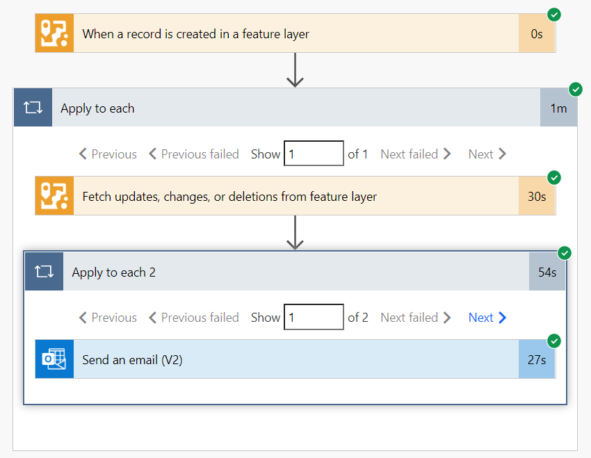

However, if we set the flow up as shown below now it does provide access to the attributes of the new feature/dynamic content but does not work as intended. Instead it sends emails for both new records and edits to existing record:
    • Apply to each
      • Fetch updates, changes or deletions
      • Apply to each 2
      • Send an email

Note that there are 2 items returned by the fetch action but no way to discern that only ‘point 6’ was the newly created record. ‘Point 5’ already existed and was merely edited.
Therefore, @SeanKMcGinnis how do I set up a flow to only send an email when a new feature is created that also provides access to attributes/dynamic content?

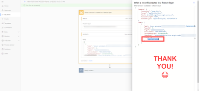

Hi Sean,
I do have an open case regarding this issue but figured I would try here also.
I've had flows running successfully for about 6 months now and they continue to work. However, any new flow I create simply does not. Everything connects, but when I go to test and trigger them, nothing happens. I've even gone as far as deleting all of my connections and reestablishing them and again, the existing ones run successfully but nothing new does. The very kind Technical Support person I've been working with and I are entirely stumped. Could the recent Microsoft outages have something to do with this? Any guidance would be greatly appreciated!
Attached is a screenshot of one of my very basic flows.
Kindly,
Cody
