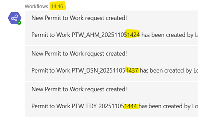

I turned off the Power Automate flows connecting to the view layers and did some testing today with the Power Automate flows connected to the main hosted feature layer. I created a point on a view layer but it didn't generate a MS Teams notification, then I waited a few minutes and tried it again but got no notification. Then a few minutes later I created a point on the main hosted layer, within two minutes I got two MS Team notifications at the same time for all three created points.

I was using the 'When a record is created in a feature layer' trigger, this works as expected when edits are made to the main hosted feature layer, but not when edits are made through one of the view layers. This seems to related to the webhook rather than the connector/trigger.
I have recreated the flow so it is now on a schedule and uses a control field as suggested here: https://community.esri.com/t5/arcgis-survey123-questions/generate-feature-report-in-power-automate-d... (again, thank you @abureaux for this resource). The flow now posts a MS Teams message regardless of whether the edits were made on the hosted layer or the view layer.
