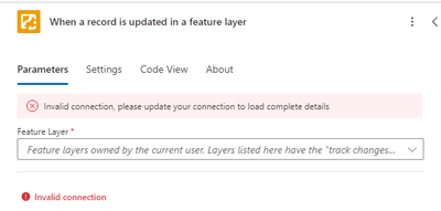

I just tried creating a new flow using the blank Build and automated cloud flow and found that in the new designer it tells me it is an invalid connection, even though it is working fine in other flows, and when I switch to the classic designer it works properly and loads my layers.
Also in the new designer the connection information for the trigger doesn't appear unless I add another ArcGIS action, it remains if I delete the action though.

Hi @RobertAnderson3 ! Thank you for posting this. We have noticed a great deal of issues in the new CoPilot designer. This is also an issue we are aware of and notated it. We have an on-going list that we will be reporting to Microsoft.
Please let me know if you run into any other odd behavior in the new designer as this is not controlled by our group.
