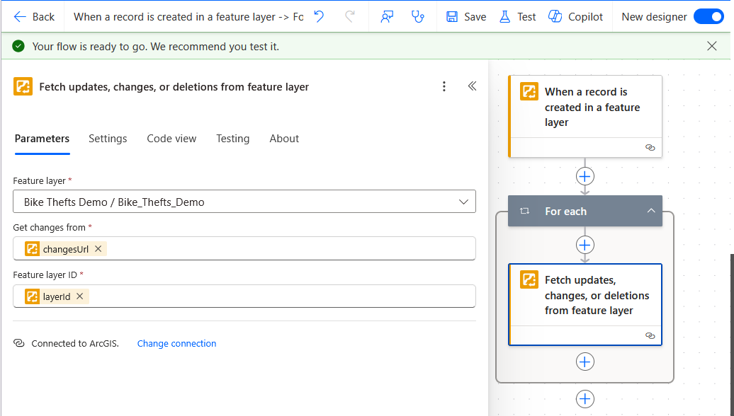

  1. After saving the flow, you should see a message saying the flow is ready to go:

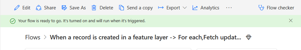

  2. Click “Back” and confirm that a confirmation message is displayed again:

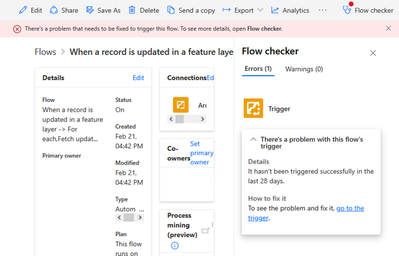

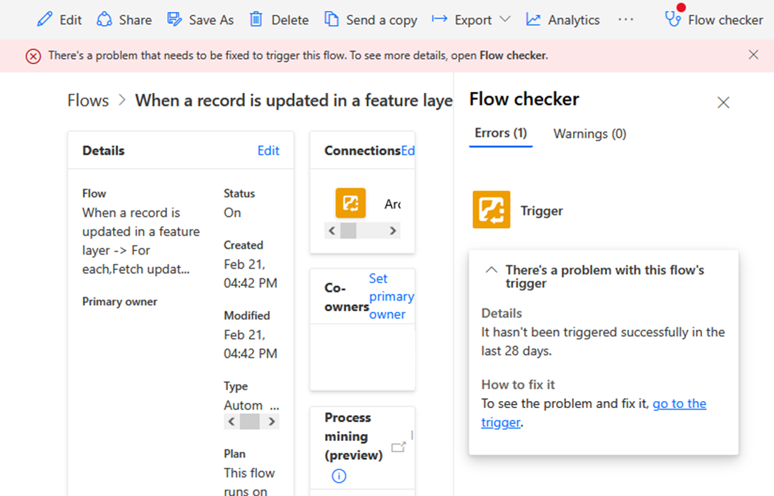

  3. If you see an error message, use the Flow checker to confirm the error message:

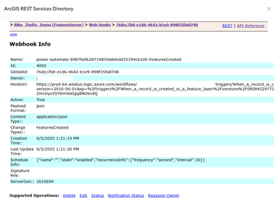

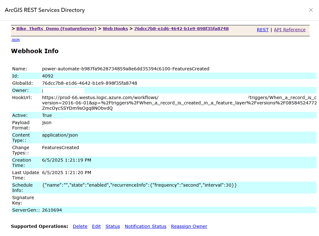

  1. To access ArcGIS Enterprise Feature service webhook navigate to `/server/admin/services/<LayerName>/webhooks`. You will need to log in as an administrator. While on ArcGIS Online navigate to the Feature Service item, look for the URL in the right pane and click “View”. After opening the services directory navigate to “Admin” on the top right corner of the page.
  1. Scroll to the bottom of the page and find “Web hooks”. You should see all the webhooks attached to the service.
  2. Access to webhook specific to your flow to confirm the webhook is active and has no errors:
  3. Click Notification Status to confirm no errors are logged there. Also, check the Status. Those actions should trigger the webhook with an empty payload.

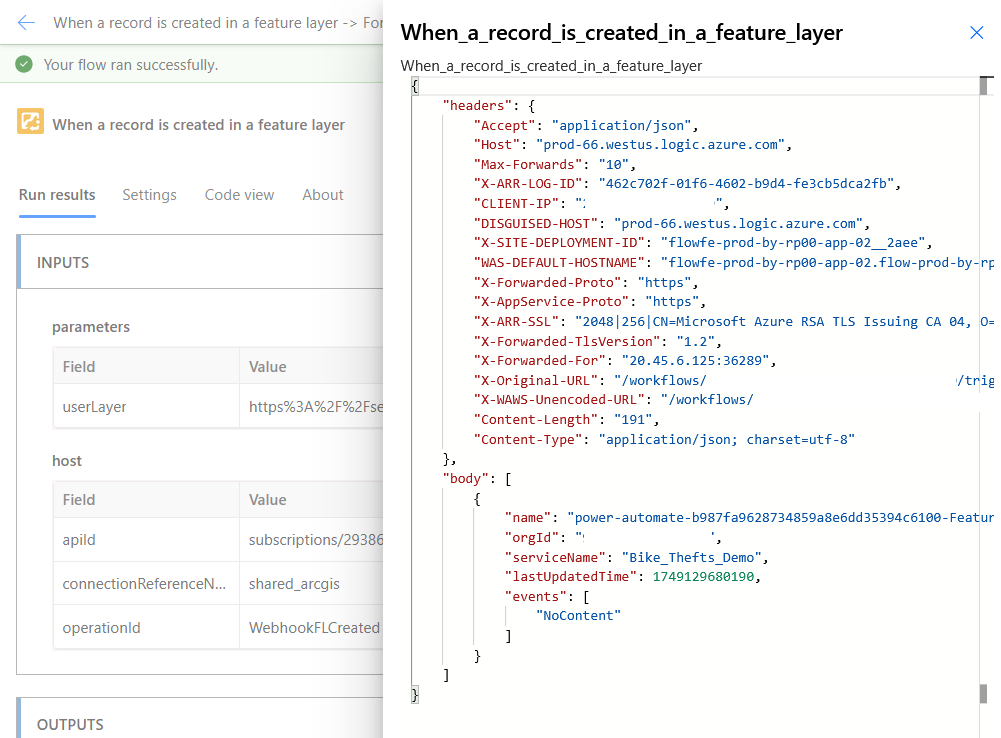

  4. Return to Power Automate and check if a run has occurred. The run may show as failed depending on the flow structure. The important information is that it was triggered.

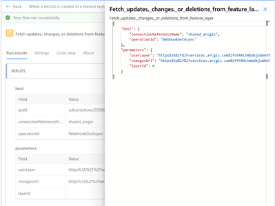

  5. Inspect the outputs of the trigger action:

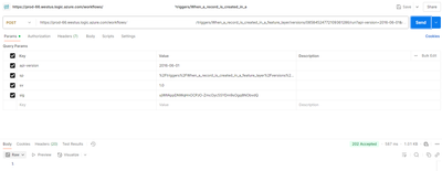

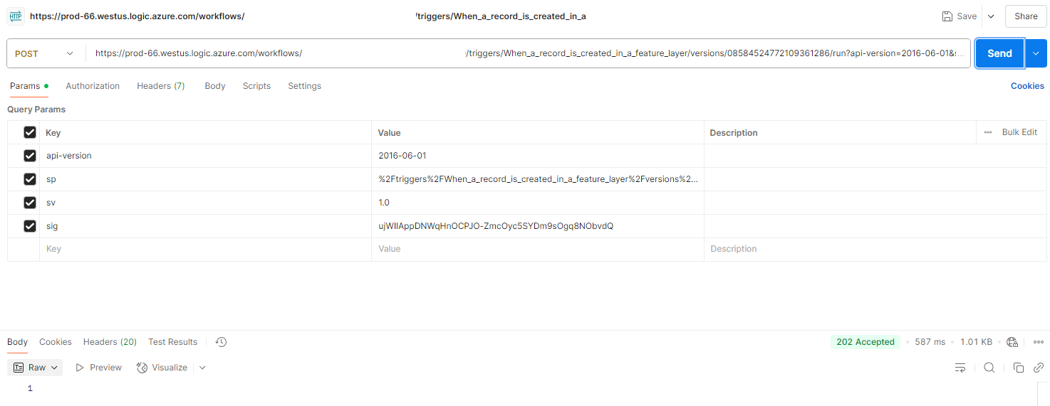

  6. ALTERNATIVE: If the previous has failed, and using a tool like Postman, make a POST request to the HookUrl:
  7. Confirm the response has a 202 Accepted status. No response body is expected.
  8. This should also add a run to the Flow history.

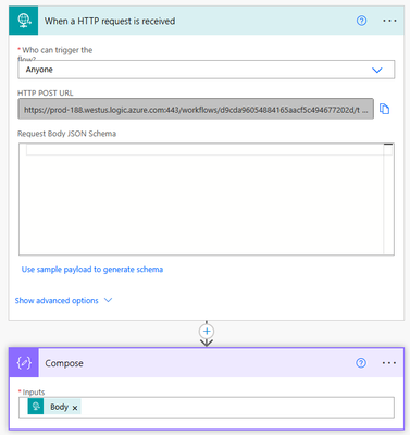

  10. If the Flow still doesn't work after changes, try creating a new flow with an out-of-the-box trigger “When a HTTP request is received”. Using this creates a new flow as shown:
  11. Set Who can trigger the flow? – Anyone to allow flow to be triggered from ArcGIS or other tools.
  12. Map the Body output to any action. In this example, we use Compose and then save the flow.
  13. Once the flow is saved, the  HTTPS POST URL is generated.

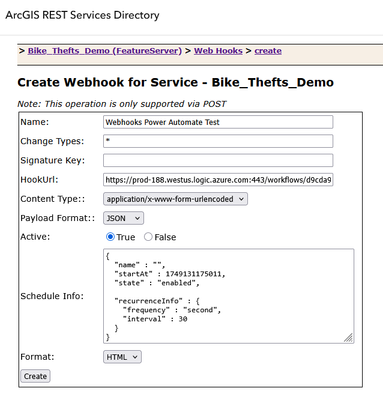

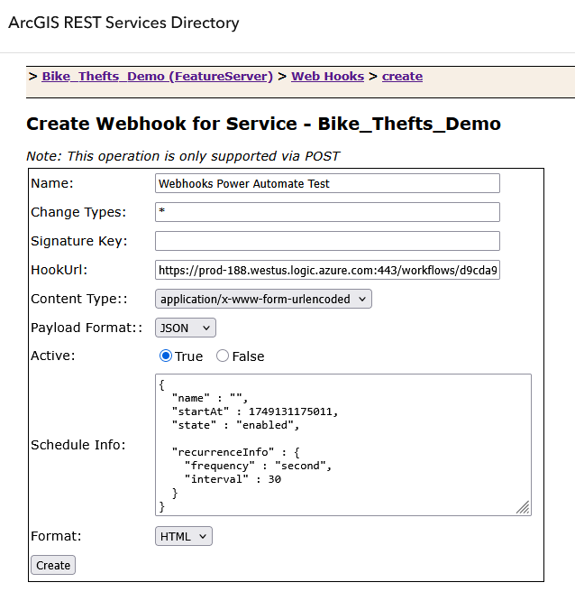

  14. Go back to the ArcGIS portal and create a webhook manually as shown:
  15. Paste the URL copied in step 11 inside the Hook URL. Set Active to True, as Change Types enter “*” to allow the webhook to listen to all changes. Click “Create”.

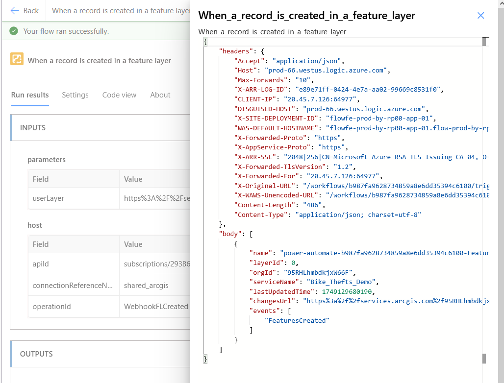

  1. Check to confirm that it is properly mapped in the action.ArcGISforPowerAutomate_10-1753196294021.png
  • . Inspect the outputs of the trigger to confirm the values are there:

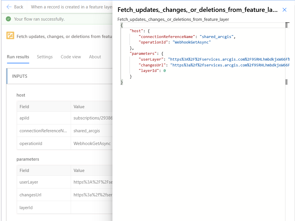

  1. If values are mapped correctly and passed to the “Fetch updates, changes, or deletions from feature layer” action, please check the response.
Possible responses include
  1. “The webhook was successfully created on the feature layer.” is returned in ArcGIS Enterprise when the webhook is created. This message could also be returned if the changesUrl is not passed to the Fetch action. Please ensure the changes URL is present in the input parameters to the Fetch action.
  2. "The response from the webhook test was successful. The flow is now ready for use." Is returned for ArcGIS Enterprise after the first change is made. Only the subsequent change will return the results.

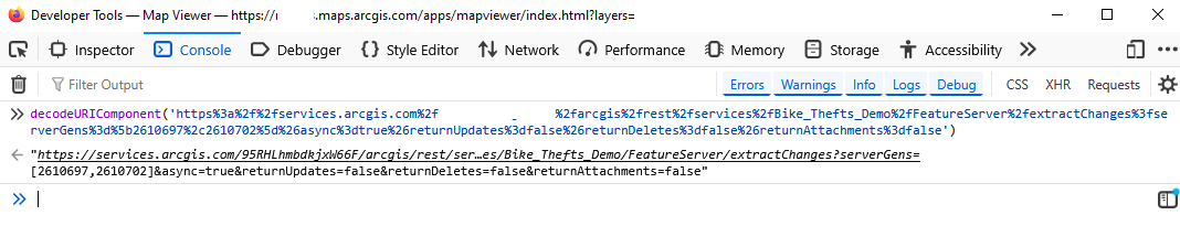

  1. You will need to get a token used in your portal. You can obtain the token from /generateToken endpoint. Alternatively, you can look for an active token by intercepting a network request going from the Portal app using the browser’s developer tools while logged in. Copy the URL from above and add your token at the end as follows:
    https://services.arcgis.com/123ABC/arcgis/rest/services/Bike_Thefts_Demo/FeatureServer/extractChange...

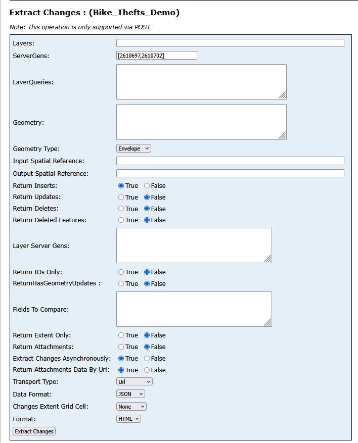

  2. Follow the link. Please see detailed API description for Extract Changes endpoint.
  3. Press Extract Changes and follow the link generated:

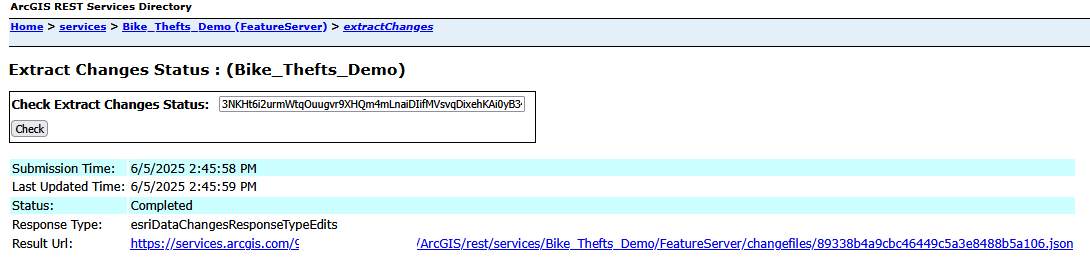

  4. Note if the Status shows “Completed”. If status is “Completed” follow the Result URL and inspect the results. The results should contain the changes that were made. If the results are as expected in the .json file but are not being returned in Power Automate please contact Esri support for Power Automate
  5. If result is “Waiting”, reload the page until Status is “Completed”.
