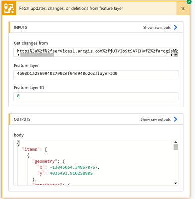

Would you be able to share a screenshot of a flow that has run? I would like to check out the outputs of the flow itself. The output should look something like this:

Here is my output, and I'm getting just empty brakets.

@NataliyaLys - Thank you for the screenshot. That is the same behavior we are seeing with the multiple reports of this issue (empty brackets).
At the moment, there is not a workaround for this issue. However, we are investigating this issue and still attempting to get to the bottom of it. I will post to this thread and the others once we have a solution to this issue.
