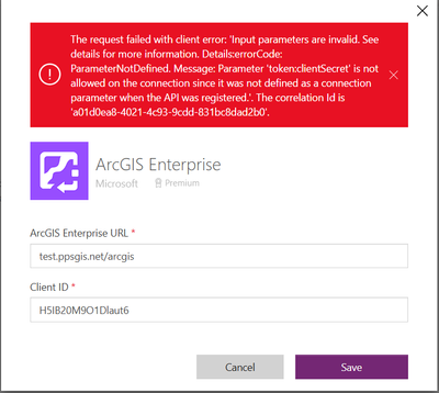

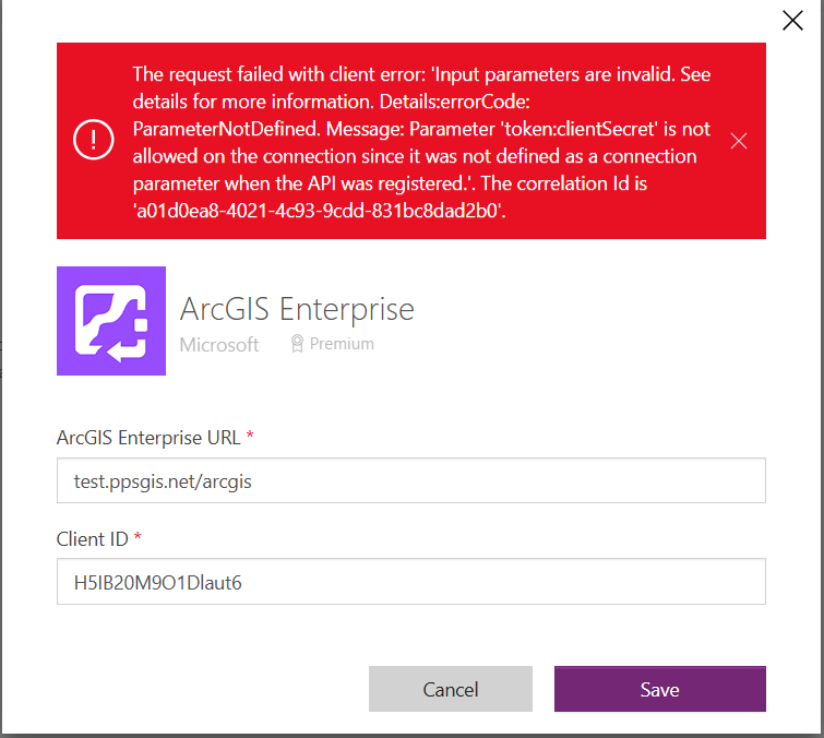

I have a flow that was working in 11.1. It sends an email when an incident is created in Field Maps. We have upgraded to 11.3 and our connection to the Enterprise is broken. I tried re-registering my custom application in the portal but it wouldn't accept the new client ID. ESRI tech support told me to replace the client ID with 'arcgisforpowerautomate' and this doesn't work either. I either get this error:
Or this one:
I get this error whether I add the client ID or 'arcgisforpowerautomate'

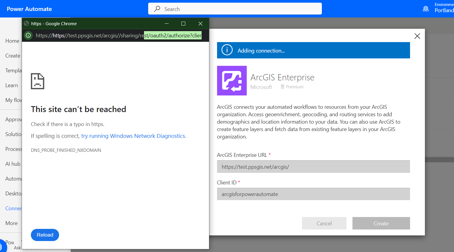

ahargreaves_FW
What if I don't have an old connection to delete? I'm trying to set this up for the first time and running into this very issue...
LeviCecil
Just add another connection and choose that one when it errors out. Some of my flows have two of the same connection, so that's how I workaround this issue
ahargreaves_FW
Sorry if I wasn't clear but I am unable to set up ANY connection. I have constantly gotten the same error and it has prevented me from making ANY connections whatsoever.

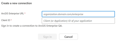

@ahargreaves_FW If you are using ArcGIS Enterprise 11.2 or above you do not need to create an application. Just click create a new connection on the action you are running and it will open the following dialog.
Use your Enterprise url without https. and use arcgisforpowerautomate as a ClientID. It should then ask you to log in.
Please also make sure that your Enterprise instance is accessible to Power Automate and is not inside a firewall or internal network. Hope that helps.
