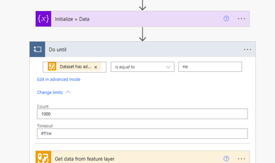

@SeanKMcGinnis - if you have a feature class over 60k records, is it best practice to query your dataset in AGOL to not exceed the Power Automate and then combine the data on the backside through a dataflow in Power BI? Or is there a way to start the 'Do Until' Loop again to go through until you have all 100k, 500k, 1M, etc. records?
********** Update ********
I don't know how I missed this, or what the limits are, but you can change how many times Power Automate does the 'Do Until' loop. I have it on 1000 and its working (but my feature class only has 70k records). The default is 60 loops.

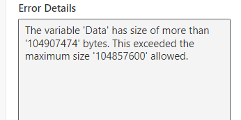

@SeanKMcGinnis  - Hi Sean, we have been using this successfully for almost 2 weeks and then the AGOL update seems to have broken our process (or maybe something else, just coincidence in timing) . We are now seeing errors like below, even though the data size hasn't changed from last week. Any ideas of what is going on? The issue started on 2/22 as far as I can see from our failure logs.
SeanKMcGinnis
@AW_Grove - I am sorry you are running into this and that is a message I have not seen before.
What triggers/actions are you using that are returning that message?

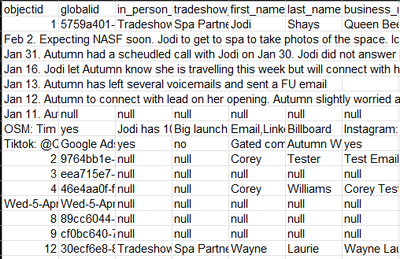

Hi @SeanKMcGinnis , thank you for this post.  It was very easy to follow and export  our org's data for use in Klipfolio.
I am exporting data from a Survey123 hosted feature layer and multi-line text questions are splitting onto next rows.  Is it possible to select the fields the exported?  Or is there a way to concatenate the iterations as JSON to use in Klipfolio?
SeanKMcGinnis
I have not encountered that issue before. When you say you are exporting them, how are you exporting them? Are you using Power Automate?

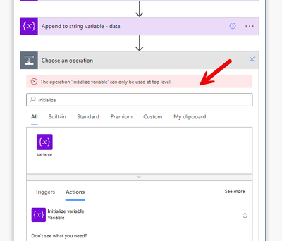

I'm trying this for the first time and it's not letting me past the Initialize Variable after the append because the initialization has to be done at the top level of the flow. Has something changed since this post?
Also, if I'm writing to JSON instead of CSV, do I need the header followed by append, concatenate, etc.? I appreciate your help.
JoabelBarbieri
Try the classic PA editor. The new doesn't allow that on the Do-Until loop
