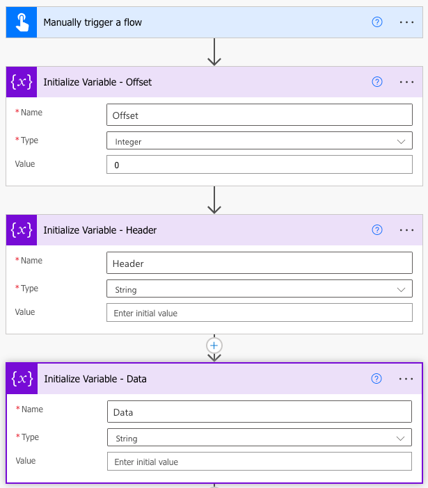

In this example, the flow is manually triggered and immediately creates a collection of variables to support the iteration through all the features in the feature layer.
Manually triggering the flow and creating three supporting variablesManually triggering the flow and creating three supporting variables
Using the Initialize Variable action, the flow creates three variables supporting different aspects of the flow. The three variables are:
  • Offset - an integer variable used to track which record the flow is working with. It supports the paging through records and keeps track of the count when there are more than 150 records and another call has to be made back to the service.
  • Header - a string variable representing the column headers which will be used in writing the CSV file
  • Data - a string variable that will hold the geometry and attribute information for the records

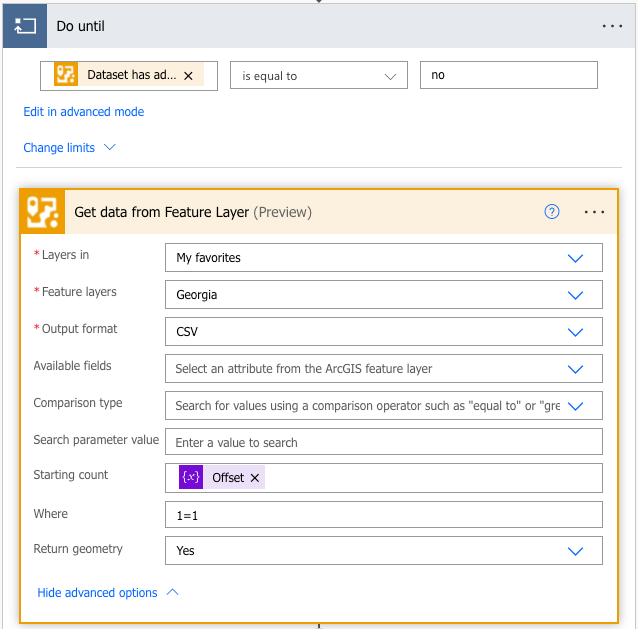

Next step in the flow is to get the data from the feature layer and iterate through all the records. To do this, use the Do until action to wrap the multiple records returned from the Get data from feature layer action.
The Get data from feature layer action needs a few user defined elements:
  • where to discover layers in the users ArcGIS Online Organization for the Layers in dialog, options allow for selecting from the user's content, the broader organization, items the user favorited, or from a custom value
  • which layer to select from Feature layers input
  • how to format the data in the Output format input - in this scenario, CSV
  • the Starting count to track where it is within the result set
  • what records to return using a Where statement. To get all of the results use '1=1', for more information on forming Where queries, review the ArcGIS REST API documentation
  • Set the Return geometry input to 'Yes' to get the geometry to display in the Power BI report

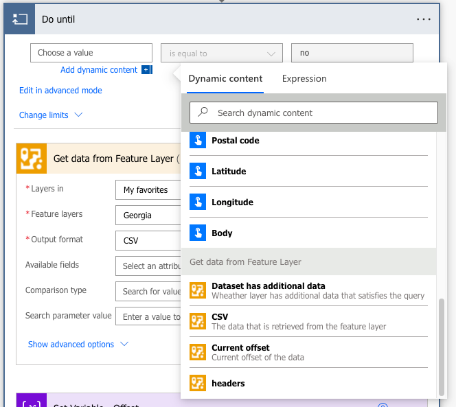

Now that the flow has data to work with, set the limit for the Do until. Click the Add dynamic content link in the Do Until action and select Dataset has additional data and set the conditional modifier to is equal to and define the modifier as no

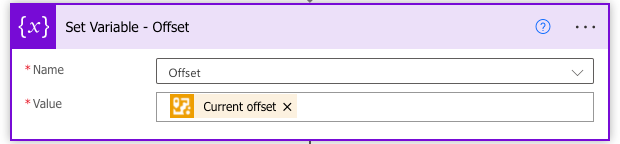

Set the Offset variable to the Current offset of the data

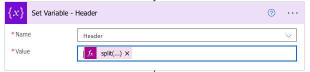

Setting the Header variable requires the flow to split the output from the data using the first row to get the column headers.
The value expression for setting the Header is:
split(outputs('Get_data_from_Feature_Layer')?['body'],decodeUriComponent('%0D%0A'))[0]

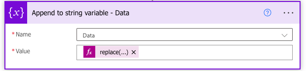

The Data variable is appended using an Append to string action replace function with the output from the dataset. This adds the geometry and attribute for each record  which will be written to the resulting CSV file.
The value expression for setting the Data variable is:
replace(outputs('Get_data_from_Feature_Layer')?['body'],variables('Header'),'')

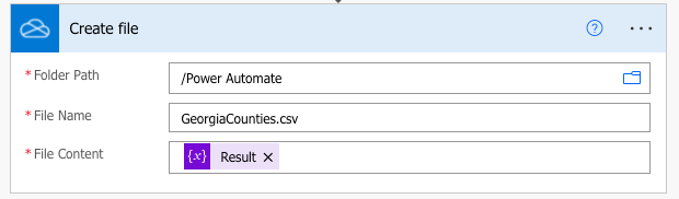

The final step is to write the Result to a CSV file using the Create file action.
The Create file action defines:
  • the folder path where the file will be saved
  • the name of the file to be saved
  • the file content, which is the Result variable that concatenated the header and data

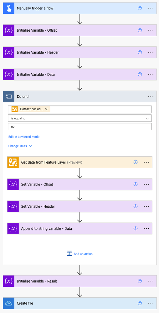

In the end, the flow looks like:

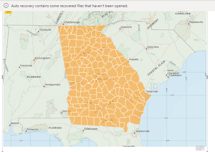

...and the visualization in Power BI looks like:
