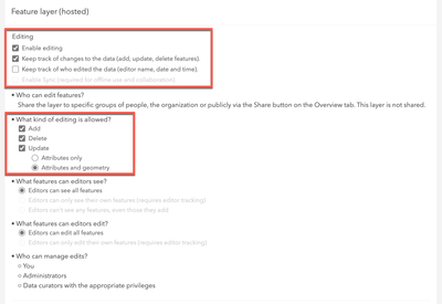

To begin, you must enable the feature layer to allow editing. If the layer does not have these options enabled, the webhook and updates will not work.
  1. Log into your ArcGIS Enterprise portal
  2. Navigate to the location of your feature layer and select it
  1. Select the layer that you want to enable editing on

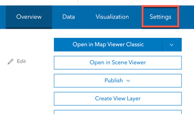

  1. Click Settings from the ribbon
  1. Scroll down to the Feature layer (hosted) section and enable the following options under Editing:
    1. Enable editing
    2. Keep track of changes to the data
  2. Under the What kind of editing is allowed section, enable the options applicable to your flow
  3. The settings will save automatically

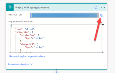

Next, we need to configure the trigger in Power Automate to obtain the HTTP POST URL. In these steps, a flow will be configured to listen for changes to the feature layer.
  1. Create a new automated flow
  2. Name your flow and then select Skip
    1. The following trigger is not in the auto-generated list when creating a flow

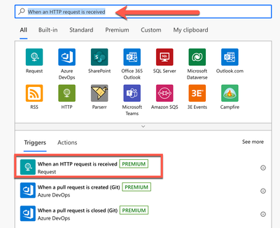

  3. In the Flow editor, search for the following trigger and select it:
    1. When an HTTP request is received
  1. In the Request Body JSON Schema, paste the following JSON into the field:

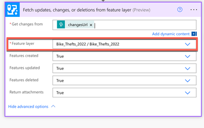

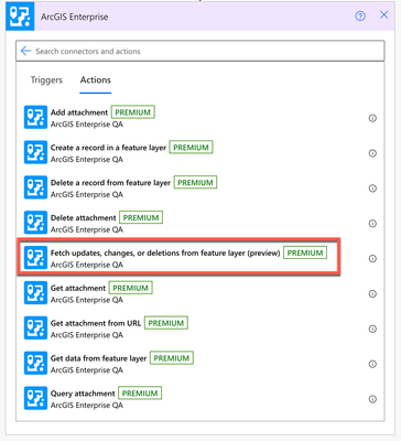

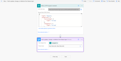

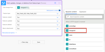

  1. Add a new action and search for the ArcGIS Enterprise connector
  2. Under the list of actions, select Fetch updates, changes, or deletions from feature layer (Preview)
  1. In the Get changes from field, select the chnagesUrl from the dynamic content list
  1. Select the layer that is needed for the webhook flow. This should be the same layer you edited in the first section of this walkthrough.

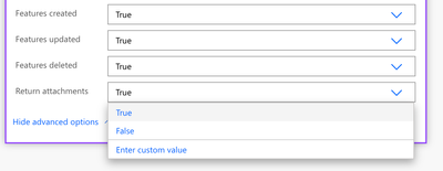

  1. By default, all the options that can be used as trigger are set to true. You can change these options based on the type of flow you are creating.

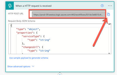

  1. Save the flow. After saving, the trigger will autogenerate a URL. This URL is needed for the next steps and configuring the webhook in ArcGIS Enterprise.
  1. After saving, you should have a flow that looks like this:
  1. Keep this tab open as the HTTP POST URL will be needed for configuration steps in the Enterprise organization

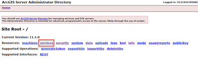

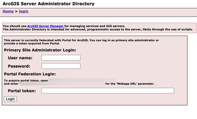

  1. Navigate to the following URL:
    1. https://organization.domain.com/server/admin/login
  2. When the page loads, you should see the following screen:

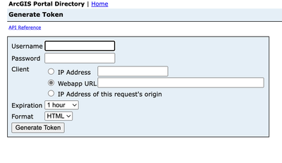

  1. In a new tab, open the following page:
  2. https://organization.domain.com/portal/sharing/rest/generateToken
  3. The following page appears:
  1. Type in the administrator’s username and password
  2. Under the Client section, ensure that Wepapp URL is selected and type in the following URL format:
    1. https://organization.domain.com:443/server/admin
  3. Set the expiration to any of the options in the dropdown. The default is one hour.
  4. Once all the fields are filled in, press Generate Token
  5. Copy the Generated Token from the new field that appears
  1. On the previous page/tab, paste in the newly generated token to the Portal token field
  2. Press Login

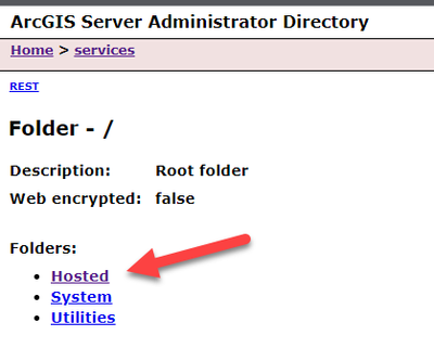

  1. Once logged in, select Services from the list of resources

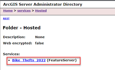

  1. Select the appropriate folder where the feature layer is stored. By default, this should be under the Hosted category

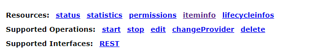

  1. Select the service you want to add the webhook to
  1. When the new page loads, scroll to the bottom of the page
  2. Select webhooks
  1. From the Supported Operations section, select create

    3. HookURL: This is the URL that was generated from the Power Automate automated flow. Paste the value from the trigger into this field.
  1. After pasting the URL, click Create
  2. The webhook has been successfully created

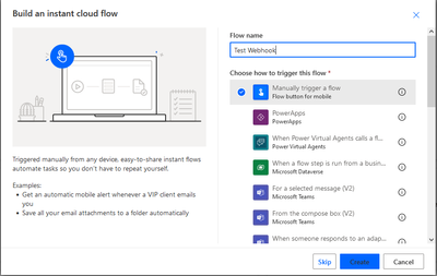

  1. Create a new Instant Cloud flow from your Power Automate landing page
  2. You can name the new action; however, it is not necessary. This action is meant as a test to see if the webhook is working and can be deleted after the test.

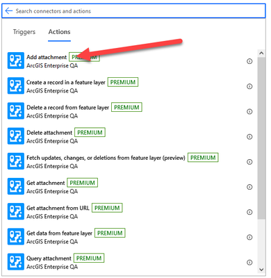

  1. Add a new step and search for the ArcGIS Enterprise connector
  2. Select Add attachment from the list of actions

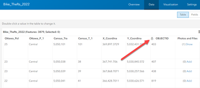

  2. For Record ID, type in an ObjectID or unique identifier from your feature layer. You may need to show this column in your data table

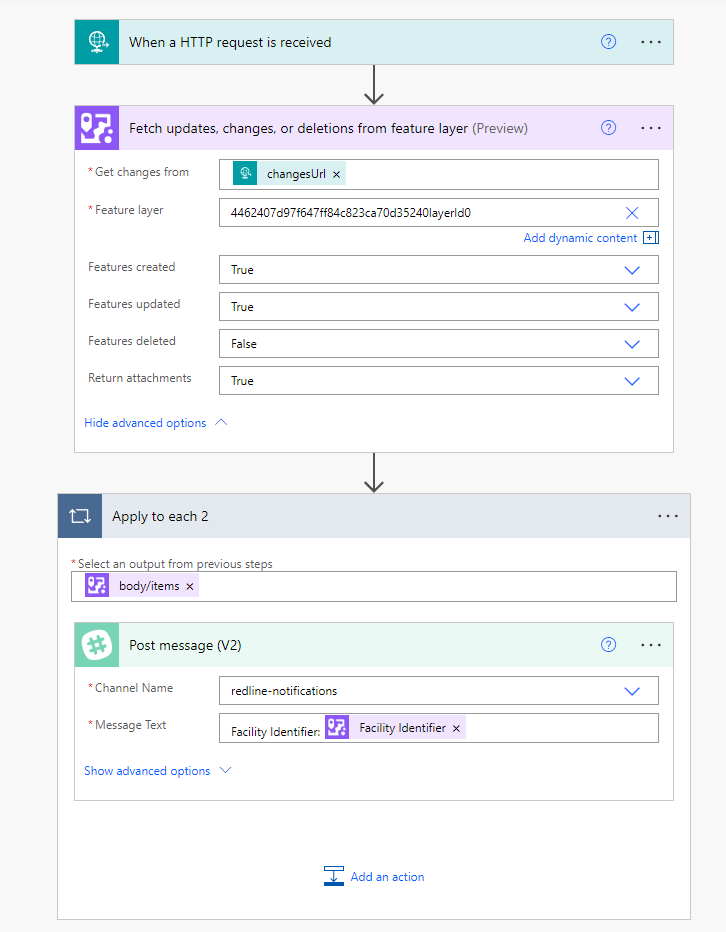

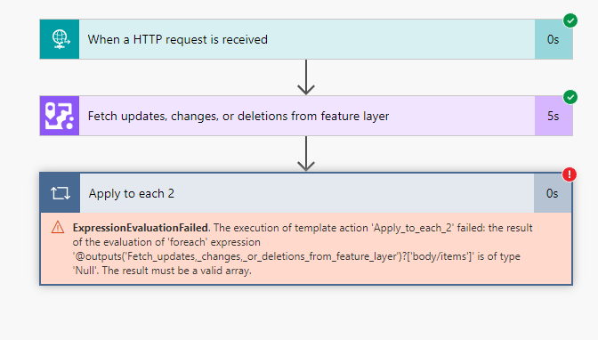

I'm trying to set up a Power Automate flow so that whenever a feature is added or updated within a hosted feature service in our Enterprise environment, a message is sent to a Slack channel notifying our team of the update and providing attribute information about the feature. In this case, I'm trying to include the Facility Identifier attribute of the created/updated feature in the body of the Slack message.
However, I keep getting the following error whenever I try to extract attribute information about the feature.

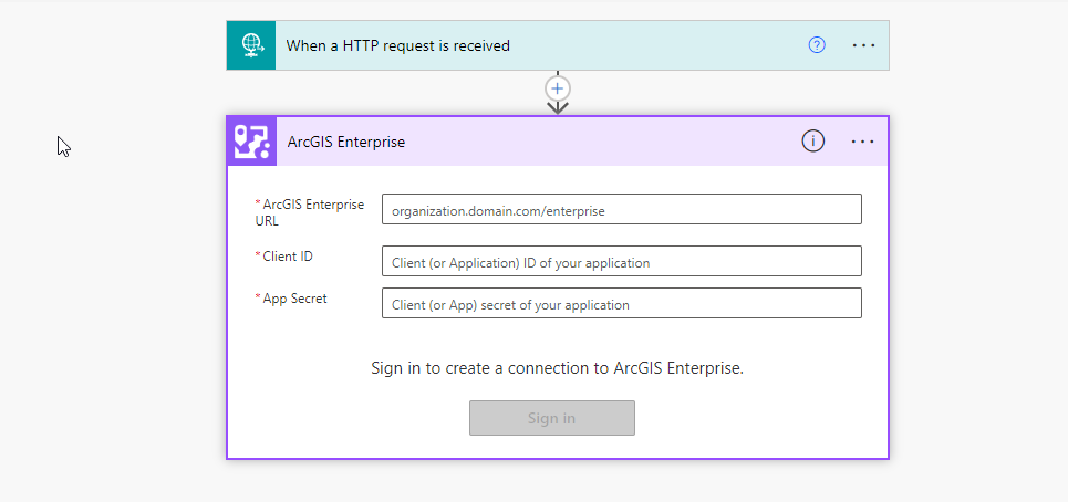

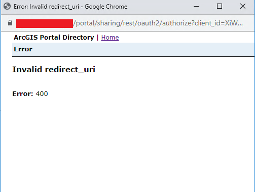

When I select Fetch updates, changes, or deletions from feature layer (Preview) I get a window that looks different than the one above. It asks for my Enterprise URL, Client ID, and App Secret. Am I doing something wrong / where do I find the appropriate Client ID and App Secret?
S_RossWygmans_GISS-T
BradyWalker2
@S_RossWygmans_GISS-T
Thank you for the link. However, after entering the enterprise url, client id, and app secret I get an invalid redirct_uri error. Any idea what could be causing this? PortalLoginAttempt.png
AnthonyLatini
Hi @BradyWalker2 - for this issue, you will need to add this application ID to your ArcGIS Enterprise URI settings. This is typically done from the Administrator's portal (backend).
What version of ArcGIS Enterprise are you running? I have seen this happen on earlier versions of ArcGIS Enterprise, but not so much on 11.0 and above.
Let me know if you have issues configuring this on the admin pane.

AnthonyLatini
Hi @S_RossWygmans_GISS-T ! Could you send me an email directly with your post so we can troubleshoot this?
Email: alatini@esri.com
Thank you!
BradyWalker2
@AnthonyLatini I'm running version 10.9.1. When I get to the Update App Info page in step 3 I see "App Info (in JSON format)". Where do I get the JSON formatted info?
AnthonyLatini
@BradyWalker2 - In most situations, this would be the typical format when setting this up. As a note, 10.9.1 is not officially supported in this component, however, once you configure these settings, it should work correctly.
Let me know if this helps!

BradyWalker2
Hey @AnthonyLatini,
That worked! Thank you so much for your help. I have another question. I don't see a webhooks option on my feature layer resources. Is this because I'm using version 10.9.1?Resources.png
AnthonyLatini
@BradyWalker2 - Awesome! I am glad that worked. That is correct. Beta support for webhooks starts at 11.1 and above.
