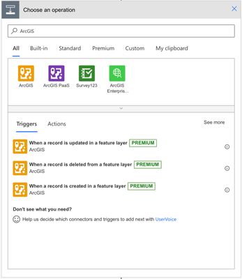

ArcGIS for Power Automate Connector - TriggersArcGIS for Power Automate Connector - Triggers
The ArcGIS Connector for Power Automate has three triggers that listen for different types of changes within ArcGIS Online feature layers (links will take you to the trigger documentation)

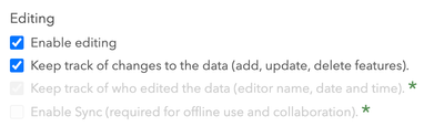

Before creating the trigger, review the feature layer's Editing settings an confirm the following options are checked:
  • Enable editing
  • Keep track of changes to the data (add, update, delete features)
  • Keep track of who edited the data (editor name, date and time)

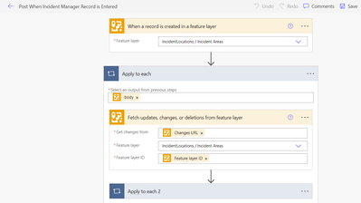

Back in Power Automate, select the appropriate trigger and choose the feature layer from the dropdown.
Select the desired feature layer from the dropdownSelect the desired feature layer from the dropdown

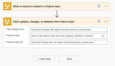

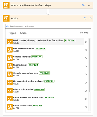

The next step is to select the 'Fetch updates, changes, or deletions from feature layer' action to handle the payload from the webhook.
Choose the Fetch Updates actionChoose the Fetch Updates action
When the action is added to the flow, it will appear as a single action in the flow.
Original state of the action when adding it to the flowOriginal state of the action when adding it to the flow
When populating the 'Get changes from' with the 'Changes URL' Dynamic content, you will notice the interface changes and gets wrapped inside an 'Apply to each' because the webhook payload may have multiple records included depending on how actively edited the feature layer is and what the webhook's interval is set to.
After completing this step, the flow can now work with the data returned as the feature layer changes.

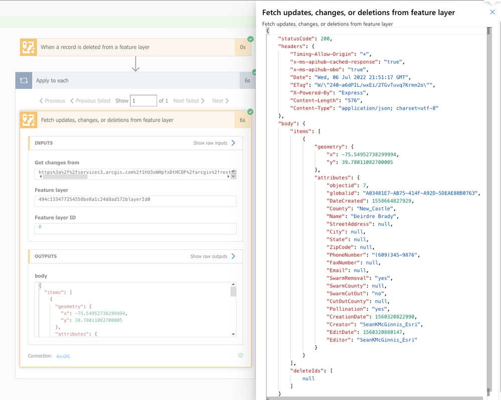

SeanKMcGinnis
@PhilLarkin1 -  I ran a test to confirm, below are the screenshots:
After successfully running the flowAfter successfully running the flow
Showing the raw output from the webhook's payload - it includes all the attributesShowing the raw output from the webhook's payload - it includes all the attributes
PhilLarkin1
This will cut a few branches from the flow tree. Excited simplify my flows.
Looks like, based on the unix timestamp in your screenshot, EditDate and Editor are not showing the user/time the feature was deleted. Is this accurate?

SeanKMcGinnis

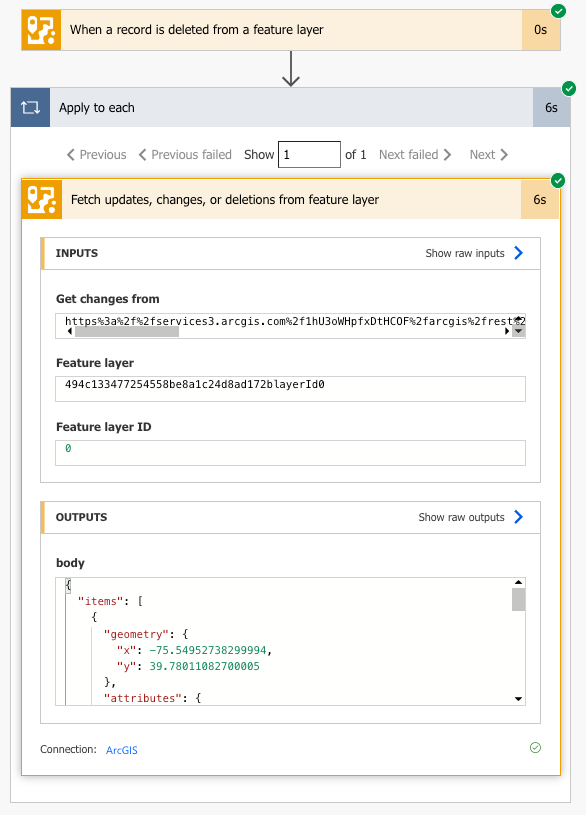

@PhilLarkin1 - there is not a deleted time returned, it is passing the attributes from the record. The closest thing I could find when looking through the flow was when the webhook was triggered. I know it is not the exact time that the item was removed, but depending on the frequency the webhook checks for edits it could be "close".

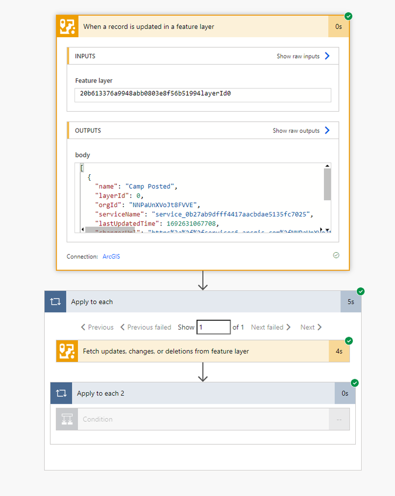

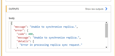

MeganHicks
@SeanKMcGinnis
Thanks for all the information on this post, it's been very helpful to get set up with this new connector!
I am running into an issue with the Fetch Updates action. The flow is able to see that a change occurred in the hosted feature service, and if I have it set to send an email directly from that trigger, it works just fine.  But when I add the step to Fetch Updates from the updated record, the flow fails. The output error is "Unable to synchronize replica", code 400. I checked in my hosted feature service that all editor tracking is enabled.
Any thoughts on what to change?
Thank you!
SeanKMcGinnis
That is an interesting issue and since it is a 400 error coming back from the service, it leads me to believe it is something going on at the service level and not in the connector. I did some research and there are a few community posts (Post 1, Post 2) where others have encountered this and it is the result of the service’s source data.
My suggestion is to check the two community posts and if it continues to open a support ticket. If you do open a support ticket, could you please send me an email at smcginnis@esri.com so I can follow along in case others encounter the same issue?
JoeyCoscia
New Explorer
Hi @SeanKMcGinnis ,
Thank you for being a resource in this esri community thread.
I am following your Power Automate workflow in attempt to post using the trigger: New record in a feature layer.
I have confirmed that following options are in the Editing settings are checked:
  • Enable editing
The flow is simply not triggered when adding a new record into the feature layer.
Is there any advice or work-arounds you can propose to troubleshoot in order to get this trigger to fire?
Thank you.
SeanKMcGinnis
@JoeyCoscia - my first question in troubleshooting is how is the feature layer being edited (desktop client, web app, Field Maps, etc)? My next question is the application performing the edits going against the feature service itself or was an editable view created for the application to work with?
For a technical way to test, I use Webhook.site and perform an edit, update, or delete to see if the webhook is firing to another client.
MeganHicks
@SeanKMcGinnis
It does seem like the issue I raised above is due to a problem with the HFS. Creating a new version of the data/HFS has fixed the issue but ideally we can fix the issue with the old HFS. Working with ESRI on that.
In the meantime, I am working on creating my email flow with the ArcGIS Connector for Power Automate. When I've used the Survey123 connector, I've used the method from Ismael here to convert times in the emails. It does not seem to work quite the same with the ArcGIS connector. Any idea on how to convert ESRI time (in seconds) to a normal time and date?
Thank you!

JoeyCoscia
New Explorer
@SeanKMcGinnis
Thank you for your prompt response.
The feature layer being edited was through an AGOL web app.
The issue was with the 5 webhook limit that is imposed on a feature service. I had to go into the webhook manager and delete some other connections!

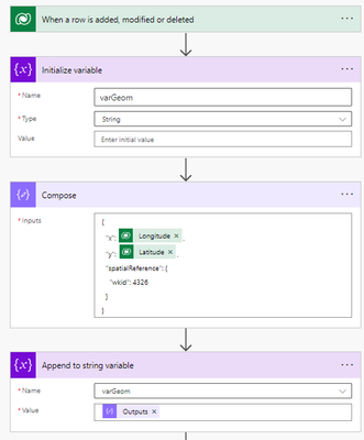

Finding this information has been a welcomed surprise! In playing with the flows, I'm able to add the record to my feature layer, but it's not updating on my map. I'm hoping to be able to have a SharePoint list trigger a Power Automate flow that will pull the an address from a SharePoint list and add it to my feature layer and display the new point on my map. In an ideal world, that new point would then be included in my buffer layer and would have my 1000' buffer around it. So far, I'm only able to get the new address added to the layer, but nothing ever shows up on my map. I do have the refresh set for both my feature layer and my analysis layer. What am I doing wrong?

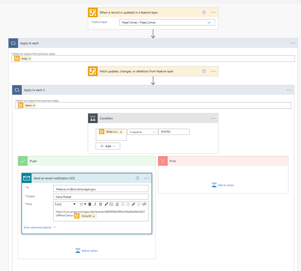

I'm trying to use the "When a record is updated in a feature layer" trigger to send an email when a feature is updated and a certain condition is met.
It worked initially, then, without changing anything in the flow or feature layer, it stopped working. The flow appears to run fine, however sometimes it registers the condition as false in cases where it is true, so an email is never sent.
Any tips? Thanks!

Did you ever find a solution to this? I think I've stumbled across the same issue which I posted about here but have had no responses on it.
It would be very useful if "Fetch updates, changes, or deletions from feature layer" could be restricted to only pull changes related to the trigger. At present it seems to pull all changes which can be an issue when using views as it detects changes that may have already been processed when the view was edited separately.
@SeanKMcGinnis is this something that could be looked into please?
