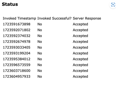

If you had recently created a webhook, it might have appeared working about 5 to 6 times before it turned off. The results on the admin page for your feature layer might have looked something like this:
Once the webhook reached its threshold of unsuccessful events, it would turn the webhook status to false. This would then stop your flows from triggering and running subsequent actions.

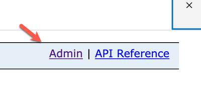

  1. In the upper right corner, click on Admin
  1. At the bottom of the page, click on “Web Hooks”

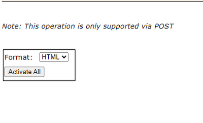

  1. Next, select “Activate all” to ensure all of the webhooks are set to TrueAnthonyLatini_8-1723756441416.png
    Click on "Activate all" to enable all webhooks.
  2. The flows in Power Automate should now start to run again
