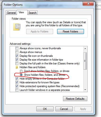

On your device, there should be an "AppData" folder that contains all data for every app on your mobile device.  I don't think it matters that you are using Windows 7.   It is possible that the AppData folder could be hidden so you may need to make hidden folders visible first.  I was  able to get Collector data of an iOS device at the time of my original post, but have since transitioned to Android, but I know it can be done.

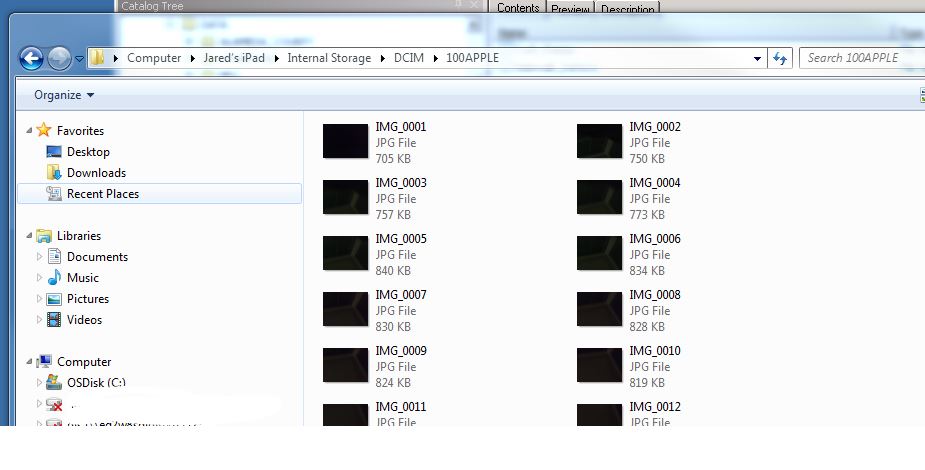

I have tried exactly both those things with no such luck. In windows explorer directly under the device all I see is a bunch of meaningless photos (image 2).

Both these locations I had on screen during the ESRI tech support screen share and they also seem confused by the lack of the folders you described. I must be missing something.
MiaogengZhang
That is file sharing. You can check out this help iTunes 11 for Windows: Transfer files between your computer and mobile apps and see if it works for you.
