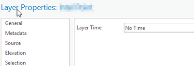

The layers time is set to  'no time':

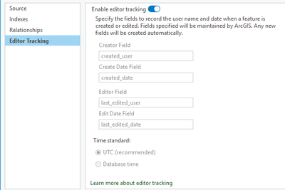

The date/time comes from editor tracking field and the time there is set to UTC.

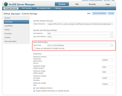

Published service on ArcGIS Server, in service settings, Parameters, the Date Field Setting Time Zone is set to 'None'. I tried UTC and local time zone but it did not change the outcome.

@lxd , When you enable Editor Tracking, you will have an option to select either UTC or Database time. This means that the Date Modified and Updated Date fields in the database will either be captured as UTC or Database time.
https://pro.arcgis.com/en/pro-app/latest/help/data/geodatabases/overview/introduction-to-editor-trac...
Has your data be enabled for versioning? Is it Traditional Versioning or Branch Versioning?
If you are using Branch Versioning, you will only be able to set editor tracking to UTC.

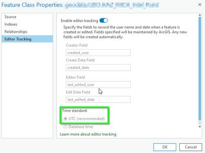

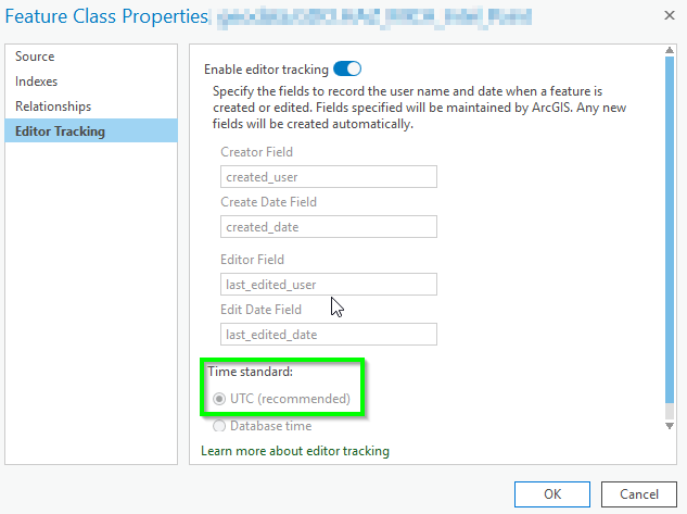

lxd
 It the menu where you select UTC or database time, I can't change it, it is  grayed out for me:
In the database connection properties, the versioning is set to traditional:
ShelleySchott
@lxd , you may need to disable and re-enable the Editor Tracking for the feature class in the Enterprise Geodatabase.
I would use the GP tools from the Toolbox in ArcGIS Pro. The Editor Tracking tools are found in the Data Management Tools - Fields toolbox. You do need to release all locks on the database and stop all services to do this task.

lxd
Thank you @ShelleySchott
I've have re-done the Editor Tracking via Geoprocessing Tools in ArcGIS Pro, I was able to set the Editor Tracking Time to database time.

Have you changed the timezone setting for the service in ArcGIS Server Manager?
If this has been set, it maybe worth logging a support ticket with your local Esri Support team to do further troubleshooting.

I have also changed the service time zone to UTC (in arcgis server manager/parameters/Date Field Setting).
After both of these changes, date/time displays in local time in Collector, web based maps and ArcGIS Pro.
