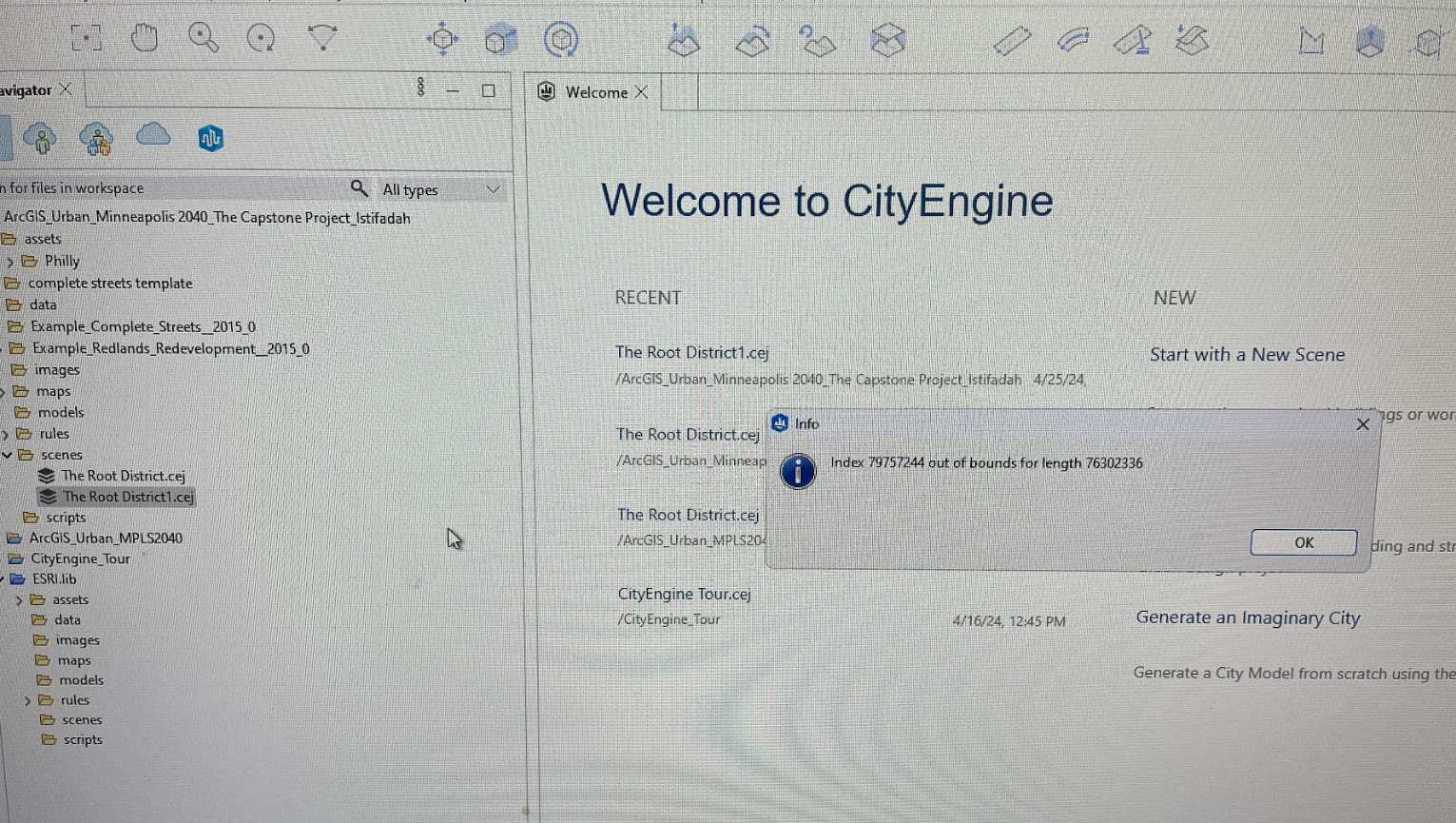

I am currently working with a student and we have a bit of an emergency - we are working with a project in City Engine, and after adding a some terrain to it, the project won't open. It returns an error message "Index 79757244 out of bounds for length 76302336". The data looks like it's still in the project, but we are unable to open it.
Hopefully there is a way to fix it! Freaking out a bit!

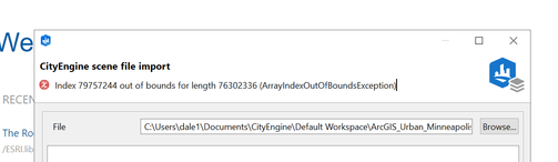

For some additional details today - I was able to get some more information on the error when I run it through the file import:
When I look in the Scene file, the data is definitely still there, so I don't think it was deleted or anything. It's just a matter of trying to fix the error message.

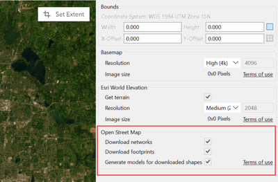

It appears the issue is with the network import. If you go to Get Data > set an extent > in the Open Street Map section, make sure that Download network is not checked before you download information:
Apparently, there is a limitation of the amount of data that can be downloaded, however - there is no error message or alert that will pop up to tell you the limitation. If you are downloading data for a very rural region, or a small area (maybe only a few blocks), it's probably fine. But for urban regions it will most likely cause the project to crash.

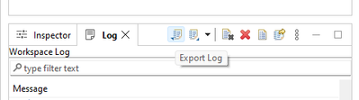

So far I was not able to reproduce the issue and therefore we don't know exactly how and why it happened. For further investigation it would be really helpful if you still have log entries from the scene got saved.
This would be very helpful. Sorry again we where not able to recover more.

I still have the a copy of the project that was showing the error - I should be able to retrigger it on the computer and get you the logs! I do remember that there was list item about there being an issue with Nahimic Service (some think it's a virus, but it's actually sound process service typically found on gaming computers. it's optional, so if you're not actually gaming on the machine, you don't really need it)

I'll see if I can get a copy of those logs!
