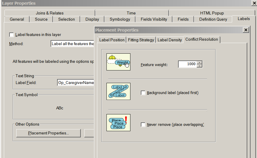

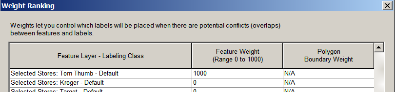

Hi Sara,
You are correct that you need to change the feature weight for your point layer.  However, in order to avoid overlap completely, the value that you need to use is 1000.
This is how I typically set this:
You can also set the feature weight from the Layer Properties-->Labels tab-->Placement Properties-->Conflict Resolution tab:
This should solve your problem.

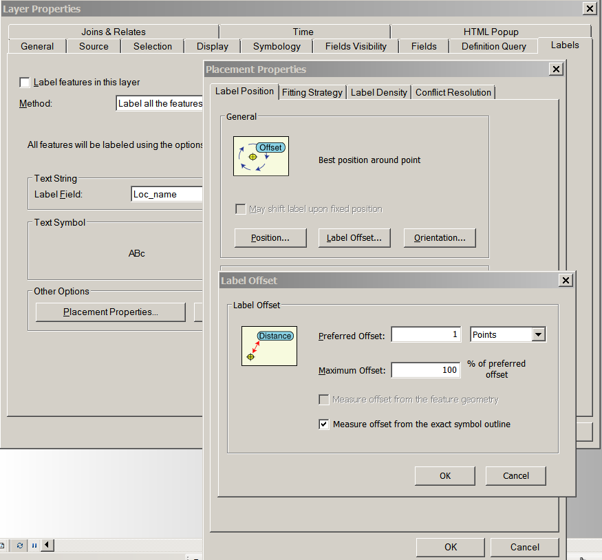

As a side note, you may also notice that sometimes when you use a large symbol for your point layer, the labels for the point layer may be overlapping the point.  To fix this issue, you would use Layer Properties-->Labels tab-->Placement Properties-->Label Offset ...-->Measure offset from the exact symbol outline option.

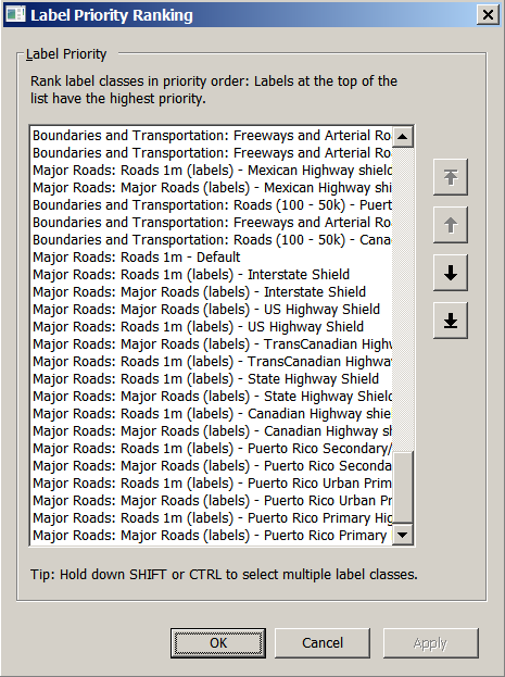

A few more things to try:  check the label setting for the highway shields and make sure that they do not have a high priority or have a setting that allows overlap.
