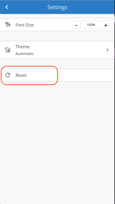

@GarrettRSmith
If there is any changes in the feature layer specification, you don't need to re-publish the app, you would need the end-users to press Reset in the Quick Report app. From the hamburger menu on the top right corner -> Settings -> Reset.
