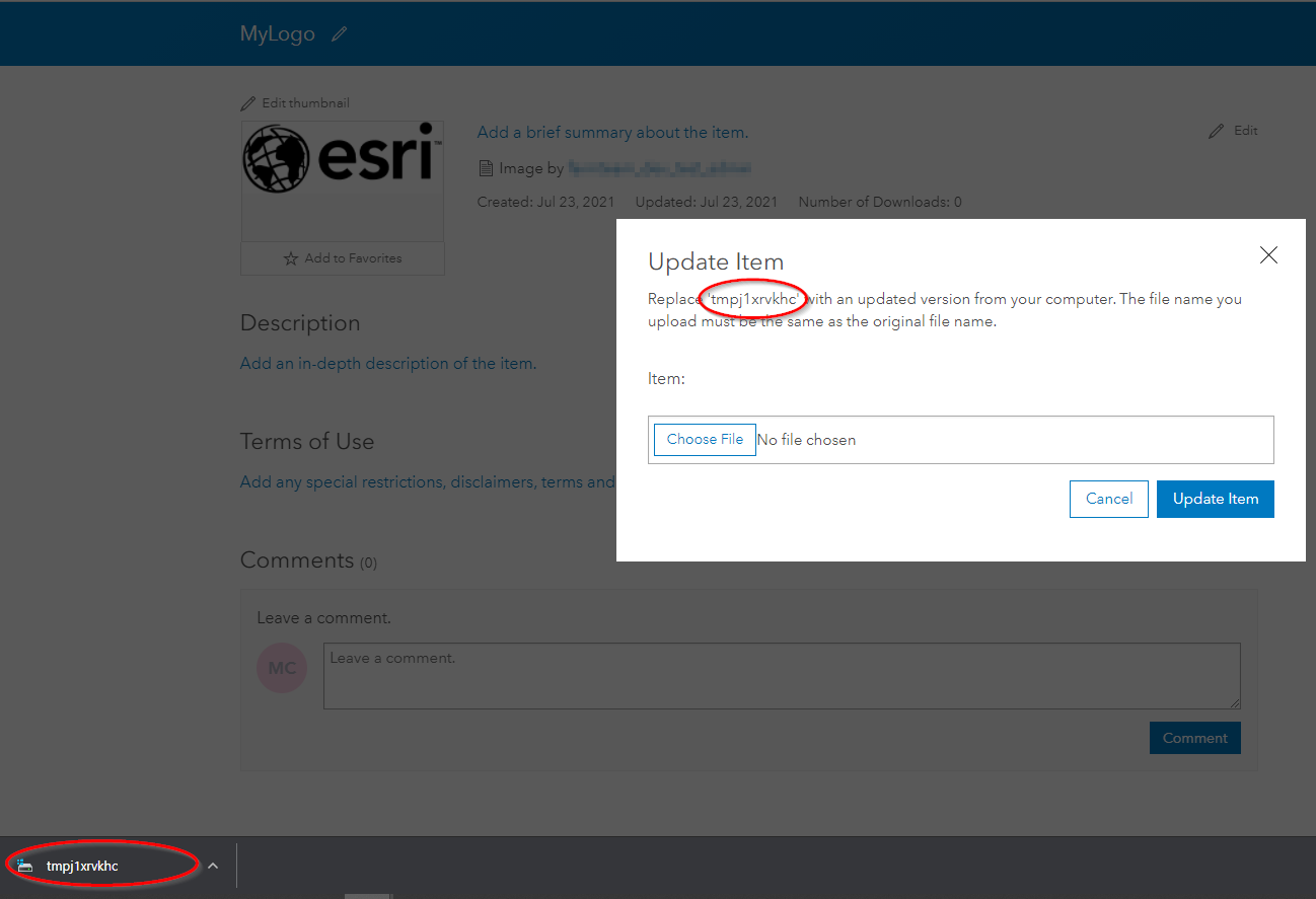

I am having an issue where files uploaded to Arcgis online don't have a proper filename or extension. They are given a random filename such as "tmpeqklflj2" with no extension i.e. this is the file you get when downloading back from AGOL.
This only happens when I add content via a URL (as opposed to uploading from a local file)
I'm working with TPK's but as a quick example, say I add an image file from the below URL (an esri logo as an example). You can see that the filename assigned is not the same as the actual name of the file, but is given the filename "tmpj1xrvkhc" with no extension.
Am I missing a parameter or is there a way to update the resource filename after? I can see that when adding or updating an Item Resource it's possible to assign a filename  a file to an Item as a Resource but only when adding or updating a new file from the local disk. Similarly the updateResource of the REST API seems like it could do it but I haven't been able to get that to work either.

So I couldn't resolve this error, but have a couple of workarounds. I also figured out how to define the filename when adding an item (see first example)
Method 1:
Catch the error and just programmatically check that the file has been added after. For anyone reading this thread, I also was able to define the filename for a file added via URL, so if the "exception" issue could be resolved then this method works fine.

emedina
Seems like the add method is imperfect, because this works as expected querying the REST API directly.
Anyhow, this fixes your example:
url = "https://www.esri.com/content/dam/esrisites/common/logos/esri-logo.jpg"
properties={
    "title": "MyLogo",
    "tags":"logo",
    "type": "Image",
    "extension": "jpg",
    "dataUrl":url
# Below triggers an exception, but actually works..
newitem = gis.content.add(item_properties=properties)
# Below triggers no exception, but is redundant. Still produces the intended result
newitem = gis.content.add(item_properties=properties, data=url)
So, what you're missing are the type and extension properties.
