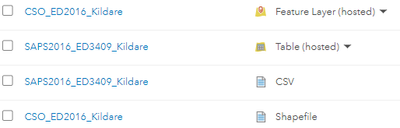

Add the Shapefile zip to AGOL as an Item. This contains the County Kildare Electoral Division boundaries. The zipped folder is available for download at the end of the blog post (CSO_ED2016_Kildare.zip)
## path to zipped folder that contains the Shapefile
shp_zip = r"path\to\CSO_ED2016_Kildare.zip"
## add the Shapefile as an item to AGOL
shp_agol = agol.content.add(item_properties={}, data=shp_zip)
Add the CSV file to as an Item. The CSV contains census information (10 of the 799 ). The CSV file is available for download at the end of the blog post (SAPS2016_ED3409_Kildare.csv).
## path to csv file
csv_file = r"path\to\SAPS2016_ED3409_Kildare.csv"
## add as csv item in AGOL
csv_agol = agol.content.add(item_properties={}, data=csv_file)
We used the ContentManager add() method to add these items, you can find more information about this method here.
Publish the Shapefile Item as a Feature Service.
## publish hosted feature service
shp_fs = shp_agol.publish()
Publish the CSV Item as a Hosted Table.
## publishing properties so csv is added as a table and not a spatial layer.
csv_properties = {
    "type:" : "csv",
    "locationType" : "none"
## publish hosted table
csv_ht = csv_agol.publish(publish_parameters=csv_properties)
We used the Item publish() method to publish our Hosted Services, more information on the publish() method can be found here.

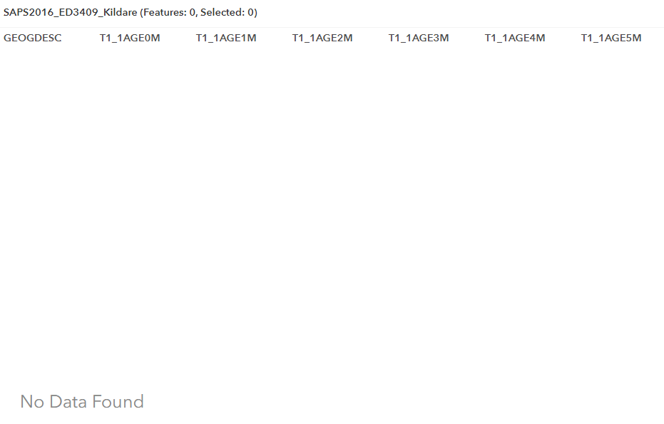

Check the Feature Service and see if the Table was added.
And check the Data tab to see that the fields have been added.
Notice that the data is missing. Essentially we have added the Table schema to our Feature Service. Next, we add/append the data from the original CSV.

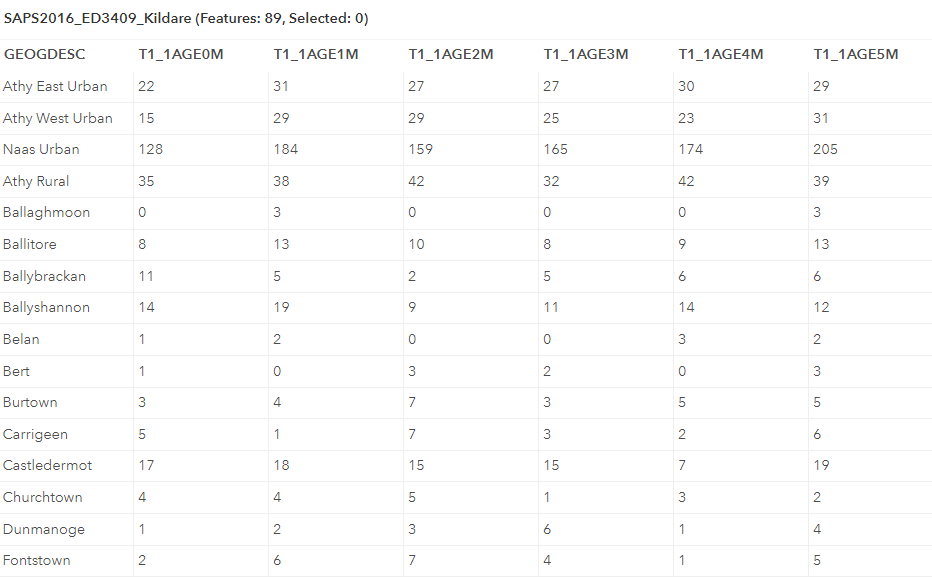

## use analyze as per append docs when using a csv
csv_data = agol.content.analyze(
    item = csv_agol.id,
    file_type = "csv",
    geocoding_service = None,
    location_type = None
## reload the Feature Service with the Table added
shp_fs = agol.content.get(shp_fs.id)
## access the Table
tbl = shp_fs.tables[0]
## append in data
tbl.append(
    item_id = csv_agol.id,
    upload_format = "csv",
    source_info = csv_data,
    upsert = False
We used the ContentManager analyze() method to prepare the data for the append() method. More on the analyze() method can be found here, and the append() method for a Table object can be found here. Refresh or navigate back to the Data tab for the Table in the Feature Service and check if the data has been successfully added?

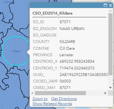

Let's check that the relationship was created successfully. Open the data in a Map and click on a Polygon. The Popup Window should contain a link Show Related Data, click it.
Look at that!
