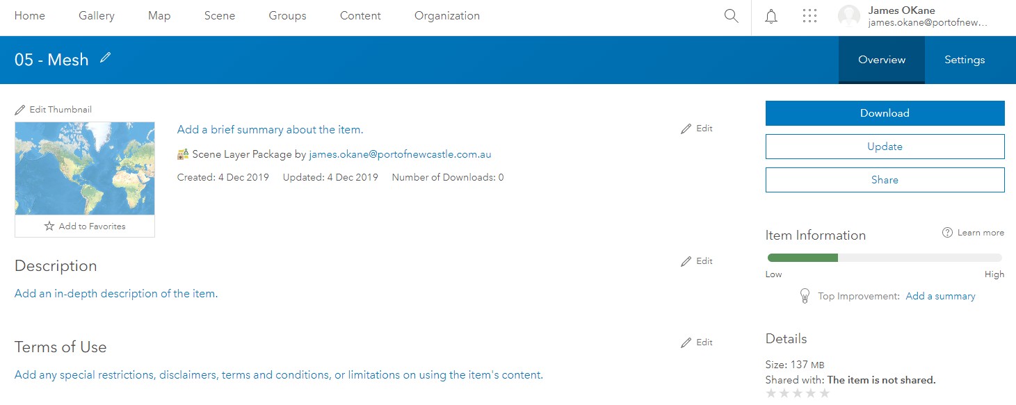

Hi,
I wanted to check out some canned 3D data provided from a 3rd party. Its a scene layer package (.slpk). Works fine in Pro (v2.4.2). After failing to publish a Web Scene I attempted to use the instructions here: Publish hosted scene layers—Portal for ArcGIS | ArcGIS Enterprise. I don't seem to have the tickbox on step 7; "Check the Publish this file as a hosted layer box". Without that the portal just holds the layer package for me which isn't very useful. I couldn't find any other way of publishing a hosted scene layer.
Portal view of scene layer package
The data I'm uploading is a sales promo dataset from a 3D imagery provider and you would assume it would be rock solid.
Any assistance would be much appreciated.

Apart from the obviously long list of issues does something jump out at you? I presume that its one of these warnings that's preventing portal from ingesting it? Is there a way of repackaging the data in Pro to solve the issues?
Thanks in advance.
Cheers,
James
