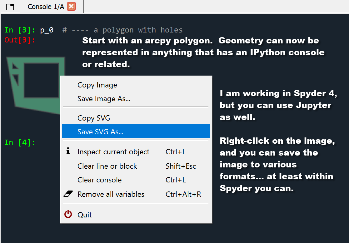

On to the Display
Inside of Spyder, which uses an IPython console,
I used my handy function for representing a numpy-based array as geometry... which I was working with.
You get a quick peek at what it looks like.

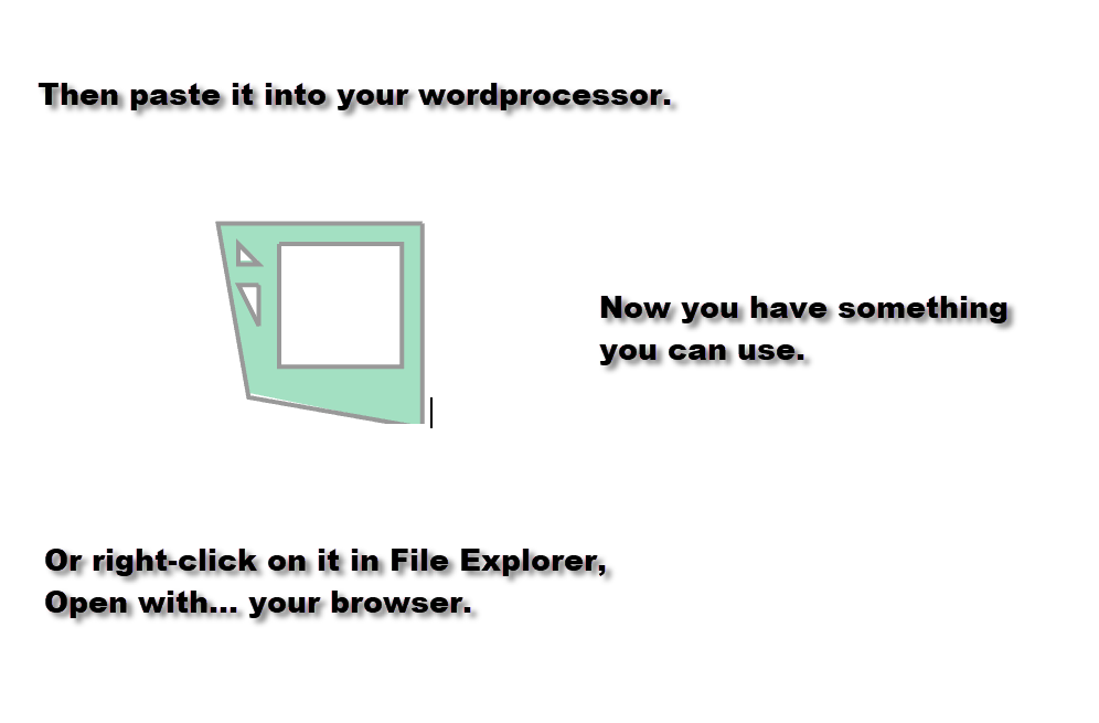

Saving the SVG
Pretty easy. Just right-click on it and you can save the SVG as an image or a *.svg file for use in such programs as Word.
