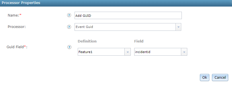

Add the processor to your GeoEvent Service and select the Event Guid processor. Then select the GeoEvent Definition your events will arrive as, and the field to put the GUID into.

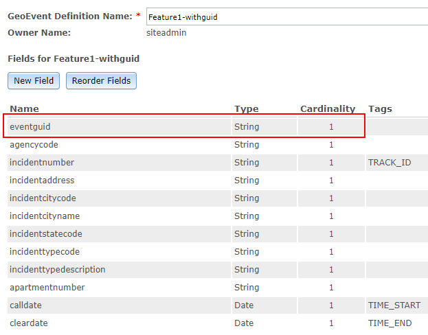

Please note, the field must be a String type field and the field must already exist in the definition. If your original event doesn't have a field to hold the GUID:

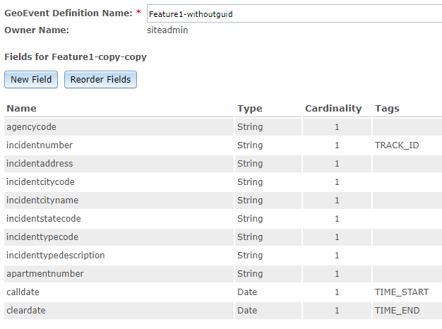

Make a copy of the definition, add the GUID field:

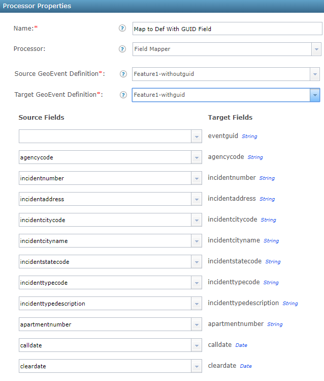

then use a Field Mapper processor to map your events into the new definition with a field to hold the GUID:

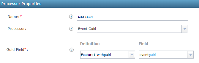

Then use your Event Guid processor to add the GUID to the desired field.
Make sure the Field Mapper processor is before your Event Guid processor.
