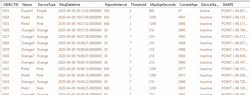

The final view SQL is as follows and the result of the view is below that:
SELECT
device.OBJECTID,
device.Name,
device.DeviceType,
device.MsgDatetime,
config.ReportInterval,
config.Threshold,
config.ReportInterval * config.Threshold AS MaxAgeSeconds,
DATEDIFF(second, device.MsgDatetime, SYSUTCDATETIME()) AS CurrentAge,
CASE
WHEN (DATEDIFF(second, device.MsgDatetime, SYSUTCDATETIME()) > (config.ReportInterval * config.Threshold))
THEN 'Inactive'
ELSE 'Active'
END
AS DeviceStatus,
device.SHAPE
FROM dbo.DEVICECURRENT AS device
LEFT OUTER JOIN dbo.DEVICECONFIG AS config ON device.DeviceType = config.DeviceType

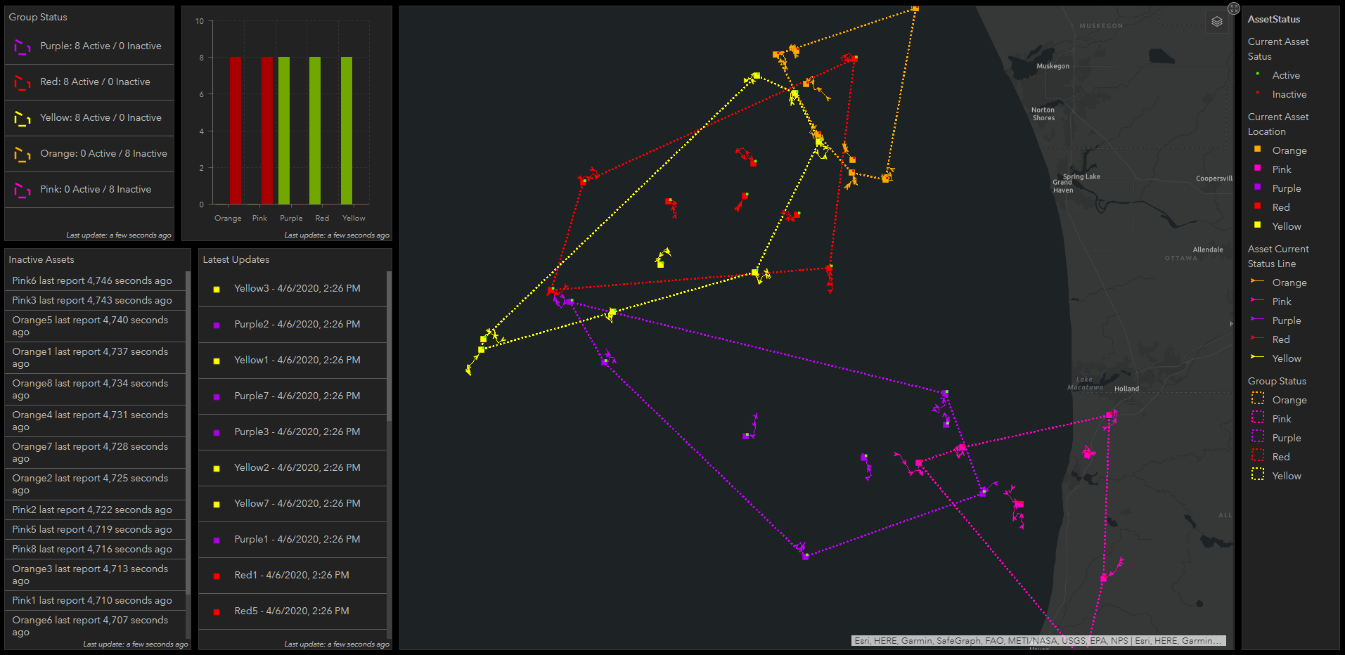

Publish the Views
Once I had the views working, I added them to a map service, created a web map and a dashboard to display each device's current location and status as well as the group status. All of that information updates in real-time based on each device's last event age.
