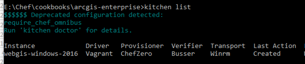

-We can now utilize our Chef Test Kitchen commands. We will first want to complete the command: kitchen list. This command will be a simple test to see if the kitchen is successfully being accessed.
-If we get a response looking like this:

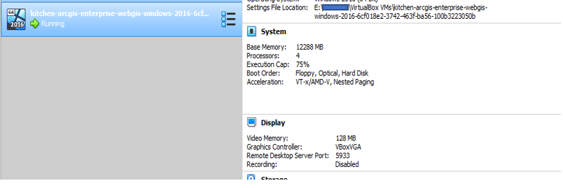

7.) We should have a Virtual machine with Windows 2016, being hosted by VirtualBox.
-The process can take a few minutes as Chef Test Kitchen is reaching out to Vagrant to import the Vagrant Box we are attempting to utilize (nickolaitc/Windows2016)
-You should be able to open the VirtualBox application and see a Windows Virtual machine.
