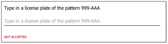

InputMask
TextField <SPAN class="punctuation token">{</SPAN>
inputMask<SPAN class="punctuation token">:</SPAN> <SPAN class="string token">"999-AAA"</SPAN>
placeholderText<SPAN class="punctuation token">:</SPAN> <SPAN class="token function">qsTr</SPAN><SPAN class="punctuation token">(</SPAN><SPAN class="string token">"Type in a license plate of the pattern 999-AAA"</SPAN><SPAN class="punctuation token">)</SPAN>
text<SPAN class="punctuation token">:</SPAN> <SPAN class="string token">"123-XYZ"</SPAN>
color<SPAN class="punctuation token">:</SPAN> acceptableInput <SPAN class="operator token">?</SPAN> <SPAN class="string token">"green"</SPAN> <SPAN class="punctuation token">:</SPAN> <SPAN class="string token">"red"</SPAN>
selectByMouse<SPAN class="punctuation token">:</SPAN> <SPAN class="keyword token">true</SPAN>
<SPAN class="punctuation token">}</SPAN><SPAN class="line-numbers-rows"><SPAN></SPAN><SPAN></SPAN><SPAN></SPAN><SPAN></SPAN><SPAN></SPAN><SPAN></SPAN><SPAN></SPAN></SPAN>View full InputMaskTest.qml on GitHub Gist.

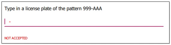

InputMask is a property on TextInput components such as TextField. It allows us to quickly define acceptable text input. In the above example we allow 6 character license plates that begin with 3 digits, followed by a dash and finishing with 3 characters. When acceptable input is entered the text field changes from "red" to "green" and the user can submit the input.
The InputMask has the following features:
- When the field is "empty" you'll see placeholders for symbols like hyphen ('-'), you will not see the placeholder text
- When you type, you do not need to type the fixed symbols, e.g. hyphen ('-')
- The code is very short
https://doc.qt.io/qt-5/qml-qtquick-textinput.html#inputMask-prop
https://doc.qt.io/qt-5/qlineedit.html#inputMask-prop

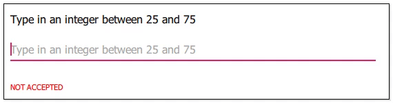

IntValidator
validator<SPAN class="punctuation token">:</SPAN> IntValidator <SPAN class="punctuation token">{</SPAN>
bottom<SPAN class="punctuation token">:</SPAN> <SPAN class="number token">25</SPAN>
top<SPAN class="punctuation token">:</SPAN> <SPAN class="number token">75</SPAN>
placeholderText<SPAN class="punctuation token">:</SPAN> <SPAN class="token function">qsTr</SPAN><SPAN class="punctuation token">(</SPAN><SPAN class="string token">"Type in an integer between 25 and 75"</SPAN><SPAN class="punctuation token">)</SPAN>
text<SPAN class="punctuation token">:</SPAN> <SPAN class="string token">"34"</SPAN>
<SPAN class="punctuation token">}</SPAN><SPAN class="line-numbers-rows"><SPAN></SPAN><SPAN></SPAN><SPAN></SPAN><SPAN></SPAN><SPAN></SPAN><SPAN></SPAN><SPAN></SPAN><SPAN></SPAN><SPAN></SPAN><SPAN></SPAN></SPAN>View full IntValidatorTest.qml on GitHub Gist.
IntValidator is a QML component that can be assigned as a TextInput validator. It allows us to quickly define acceptable numerical input. In above example we allow any integer between 25 and 75. When acceptable input is entered the text field changes from "red" to "green" and the user can submit the input.
The IntValidator has the following features:
- When the field is empty you can see the placeholder text
- You cannot type more than the number of characters hinted by the IntValidator (e.g. in the above example you cannot type more than two digits)
https://doc.qt.io/qt-5/qml-qtquick-intvalidator.html

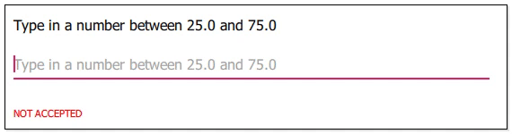

DoubleValidator
validator<SPAN class="punctuation token">:</SPAN> DoubleValidator <SPAN class="punctuation token">{</SPAN>
bottom<SPAN class="punctuation token">:</SPAN> <SPAN class="number token">25.0</SPAN>
top<SPAN class="punctuation token">:</SPAN> <SPAN class="number token">75.0</SPAN>
placeholderText<SPAN class="punctuation token">:</SPAN> <SPAN class="token function">qsTr</SPAN><SPAN class="punctuation token">(</SPAN><SPAN class="string token">"Type in a number between 25.0 and 75.0"</SPAN><SPAN class="punctuation token">)</SPAN>
text<SPAN class="punctuation token">:</SPAN> <SPAN class="string token">"34.5"</SPAN>
<SPAN class="punctuation token">}</SPAN><SPAN class="line-numbers-rows"><SPAN></SPAN><SPAN></SPAN><SPAN></SPAN><SPAN></SPAN><SPAN></SPAN><SPAN></SPAN><SPAN></SPAN><SPAN></SPAN><SPAN></SPAN><SPAN></SPAN></SPAN>View full DoubleValidatorTest.qml on GitHub Gist.
DoubleValidator is a QML component that can be assigned as a TextInput validator. It allows us to quickly define acceptable numerical input. In above example we allow any number between 25.0 and 75.0. When acceptable input is entered the text field changes from "red" to "green" and the user can submit the input.
The DoubleValidator has the following features:
- When the field is empty you'll see the placeholder text
- You can type in any length (because decimal points are allowed)
https://doc.qt.io/qt-5/qml-qtquick-doublevalidator.html

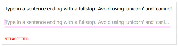

InputValidator
validator<SPAN class="punctuation token">:</SPAN> InputValidator <SPAN class="punctuation token">{</SPAN>
validate<SPAN class="punctuation token">:</SPAN> <SPAN class="keyword token">function</SPAN> <SPAN class="punctuation token">(</SPAN>input<SPAN class="punctuation token">,</SPAN> position<SPAN class="punctuation token">)</SPAN> <SPAN class="punctuation token">{</SPAN>
<SPAN class="keyword token">if</SPAN> <SPAN class="punctuation token">(</SPAN>input<SPAN class="punctuation token">.</SPAN><SPAN class="token function">match</SPAN><SPAN class="punctuation token">(</SPAN><SPAN class="regex token">/unicorn/</SPAN><SPAN class="punctuation token">)</SPAN><SPAN class="punctuation token">)</SPAN> <SPAN class="punctuation token">{</SPAN>
<SPAN class="keyword token">return</SPAN> InputValidator<SPAN class="punctuation token">.</SPAN>Invalid
<SPAN class="keyword token">while</SPAN> <SPAN class="punctuation token">(</SPAN>input<SPAN class="punctuation token">.</SPAN><SPAN class="token function">match</SPAN><SPAN class="punctuation token">(</SPAN><SPAN class="regex token">/canine/</SPAN><SPAN class="punctuation token">)</SPAN><SPAN class="punctuation token">)</SPAN> <SPAN class="punctuation token">{</SPAN>
input <SPAN class="operator token">=</SPAN> input<SPAN class="punctuation token">.</SPAN><SPAN class="token function">replace</SPAN><SPAN class="punctuation token">(</SPAN><SPAN class="regex token">/canine/</SPAN><SPAN class="punctuation token">,</SPAN> <SPAN class="string token">'dog'</SPAN><SPAN class="punctuation token">)</SPAN>
position <SPAN class="operator token">-</SPAN><SPAN class="operator token">=</SPAN> <SPAN class="number token">6</SPAN>
position <SPAN class="operator token">+</SPAN><SPAN class="operator token">=</SPAN> <SPAN class="number token">3</SPAN>
<SPAN class="keyword token">let</SPAN> state <SPAN class="operator token">=</SPAN> InputValidator<SPAN class="punctuation token">.</SPAN>Intermediate
<SPAN class="keyword token">if</SPAN> <SPAN class="punctuation token">(</SPAN>input<SPAN class="punctuation token">.</SPAN><SPAN class="token function">endsWith</SPAN><SPAN class="punctuation token">(</SPAN><SPAN class="string token">'.'</SPAN><SPAN class="punctuation token">)</SPAN><SPAN class="punctuation token">)</SPAN> <SPAN class="punctuation token">{</SPAN>
state <SPAN class="operator token">=</SPAN> InputValidator<SPAN class="punctuation token">.</SPAN>Acceptable
<SPAN class="keyword token">return</SPAN> <SPAN class="punctuation token">{</SPAN> input<SPAN class="punctuation token">,</SPAN> position<SPAN class="punctuation token">,</SPAN> state <SPAN class="punctuation token">}</SPAN>
placeholderText<SPAN class="punctuation token">:</SPAN> <SPAN class="token function">qsTr</SPAN><SPAN class="punctuation token">(</SPAN><SPAN class="string token">"Type in a sentence ending with a fullstop. Avoid using 'unicorn' and 'canine'!"</SPAN><SPAN class="punctuation token">)</SPAN>
text<SPAN class="punctuation token">:</SPAN> <SPAN class="string token">"A dog is man's best friend."</SPAN>
<SPAN class="punctuation token">}</SPAN><SPAN class="line-numbers-rows"><SPAN></SPAN><SPAN></SPAN><SPAN></SPAN><SPAN></SPAN><SPAN></SPAN><SPAN></SPAN><SPAN></SPAN><SPAN></SPAN><SPAN></SPAN><SPAN></SPAN><SPAN></SPAN><SPAN></SPAN><SPAN></SPAN><SPAN></SPAN><SPAN></SPAN><SPAN></SPAN><SPAN></SPAN><SPAN></SPAN><SPAN></SPAN><SPAN></SPAN><SPAN></SPAN><SPAN></SPAN><SPAN></SPAN><SPAN></SPAN><SPAN></SPAN></SPAN>View full InputValidatorTest.qml on GitHub Gist.
InputValidator is a QML component that can be assigned as a TextInput validator. It allows us to supply a Javascript function to be the validator. The Javascript function receives both the original string and position as input. It can return an input state (InputValidator.Invalid, InputValidator.Intermediate or InputValidator.Acceptable). It can also return an object that contains an updated version of the string, position and state. Returning an updated string allows us to implement auto correction. In the above example we forbid the user from typing in "unicorn". It's not allowed! We also forbid the user from typing "canine". If they attempt to type "canine" it gets auto corrected as "dog". The sentence will never be full accepted until the user finishes it with a full stop ".".
InputValidator has the following features:
- You can prohibit certain input (e.g. we can come up with a word blacklist, e.g. censor offensive words)
- You can correct / fix input (i.e. implement auto correct)
- You have full control over the experience
- Takes more effort to implement your rules
https://doc.arcgis.com/en/appstudio/api/reference/framework/qml-arcgis-appframework-inputvalidator/
